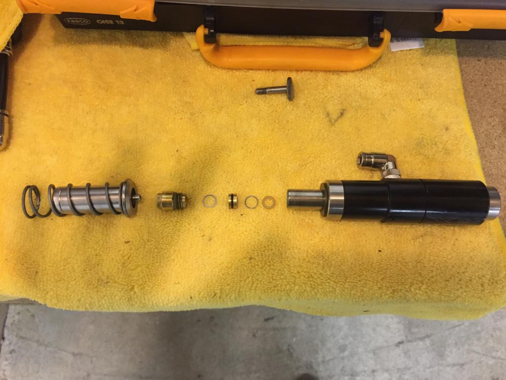

          OK. We need to find out which Level 10 carrier is in you gun now.
          1-Take the valve out
          2-Remove the brass Powertube Tip with a 3/8" wrench.
          3-using the rear field strip screw as a tool, screw it down into the powertube/carrier oring untill it grabs a bit.
          4-pull out the carrier assembly and shims if any
          5-look on the side of the carrier for any dots or lines. The amount of dots and or lines will determine what size carrier it is. Once we know that I can send you waht you need. I got your email and will reply tonight once I get the info needed here...

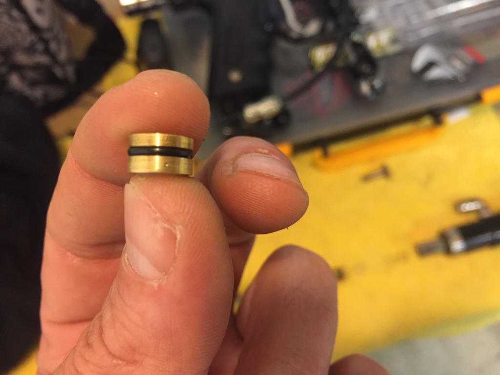

              Hi tunaman thanks for taking the time to come back to me. Ok so I stripped the bolt as you said this is what I found after taking it apart the carrier appears to have three (3) single dots on it equally spaced around its circumference. The spring as you can see is the silver one and it had two shims in the power tube too

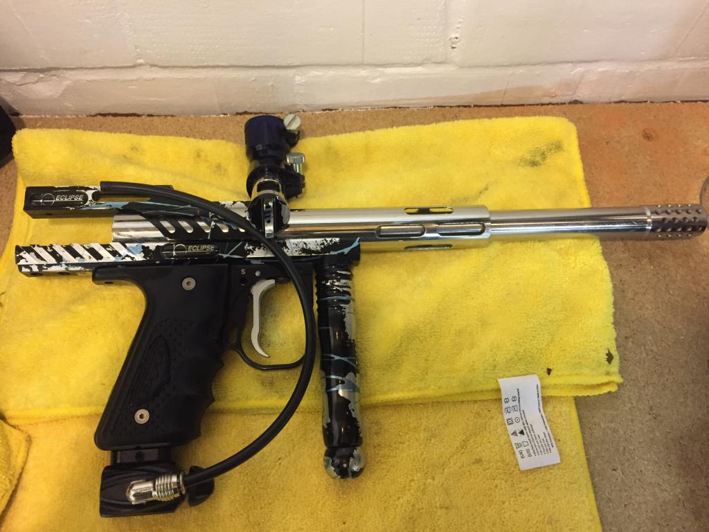

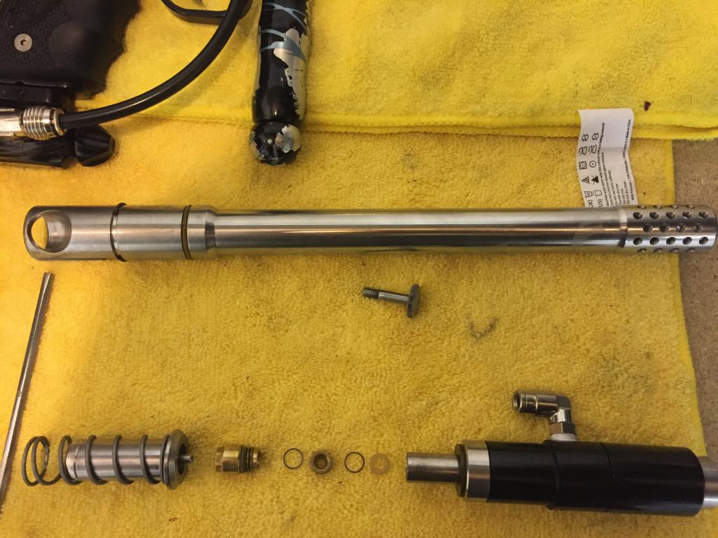

                Hi vintage, it has a twist lock type barrel that appears to be stainless steel I have not Seen one like this before I got this marker I guess it was the one supplied with it being an eclipse mag? It's fitted with the metal type detent. And is running the silver (long?) Spring.

                  If there is no line then that is a .5 carrier. You should have for the gun a #0, #.5, #1, #1.5, and a #2. You already have the .5. And I would not recommend using that longest spring either. Reliability suffers so get a red spring. You should also have the gold spring in your parts kit too.

                    Ok great just so you know I have no spares what's so ever, what you see is what I have! So I guess I need all of the bits you list above!!

                                there are no issues in having the safety. you will need to remove the trigger though which can be a pain in aluminum frames (you need to press out / tap out the trigger pin). take whatever you know about autocockers and set it aside, as it has no use with automags lol. also, those barrel o-rings are toast man...get some new ones on there, and a new plastic nubbin. the barrel is from check it, if you were wondering.
