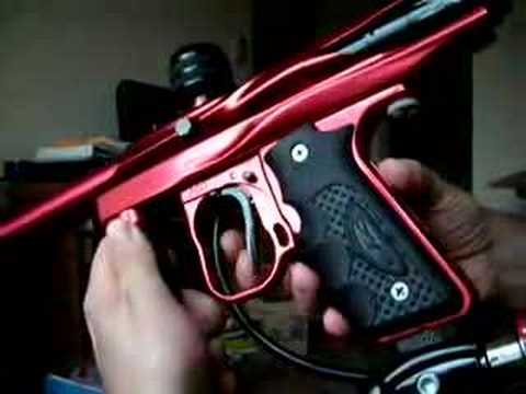

            Ok so I got my parts in the mail today from Tuna (thanks again) I have followed the LV10 set up guide and I am using the carrier with 2 lines on it and the gold (short) spring. The marker does not leak down the barrel or otherwise and it does shoot and cycle more quickly than it did previously, however when I try to rapid fire it still 'chuffs' occasionally. It's clearly still not right any ideas anyone?
              Does the bolt return or does it stick?
              Chuff could also be just that your trigger discipline is failing and you don't completely pull or release the trigger. Or it could be the lvl 10 preventing chop.

                Ok it's being dry fired but if I was a betting man it sounds like the bolt is still sticking? Do I need to try a different carrier? If so which one?
                I took a video of it shooting take a look
                  If it sticks then the the bolt won't return. I'd leave the carrier that you are using for now (it's anyway the largest you have). Try it first with paint/reballs and see what it does.
                  It could also be that your field strip screw is little loose and allows some movement on the valve which then misaligns with the body causing stick. One indication of this is if the bolt unsticks when you push from the back of the valve.

                    Ok the bolt is returning as it shoots when you pull the trigger again, I have adjusted the trigger rod leaving a credit cards width between it and the trigger. If that is the largest carrier it's strange as when I used the others earlier on they leaked? I'll put some paint through it and see what happens.

                          Originally posted by Systemx View Post
                          Ok thanks for the info on the carriers it's good to know, did you have a chance to look at the video?
                          Hah, totally missed it when I first read this from my mobile. But that definitely looks like you're not letting the trigger forward enough, it'll do chuffs when you do that.

                            Ok I'll work on it but the trigger just feels a bit clunky, I just figured that the Mag would shoot quicker than it does especially with the inteli frame? I take it all appears ok with the Mag apart from that? Also I cannot seem to get the reactive trigger working? The output pressure of my tank is 850psi which should be enough pressure?

                              It can shoot very fast if your fingers can keep up. Yeah, everything looks ok as far as I can tell from the video.
                              RT effect will come in time (at least for most of them it does) as the o-rings break in. Of course this also depends of the flow rate of your tank regulator and its output pressure (should be at least 800 psi ).
