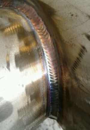

                            If it were properly welded it would probably be OK (TK cringes, lol) but someone with the proper skills would have done a much better job than that, as that looks pretty sketchy. If I were you I would try and find another damaged valve with a good power tube and switch them out.
                            Personally, I would never trust it unless I did it myself or if it looked something like this. This I wouldn't hesitate to use, but your weld is not even in the ball park.
                              [ATTACH=CONFIG]93819[/ATTACH]
