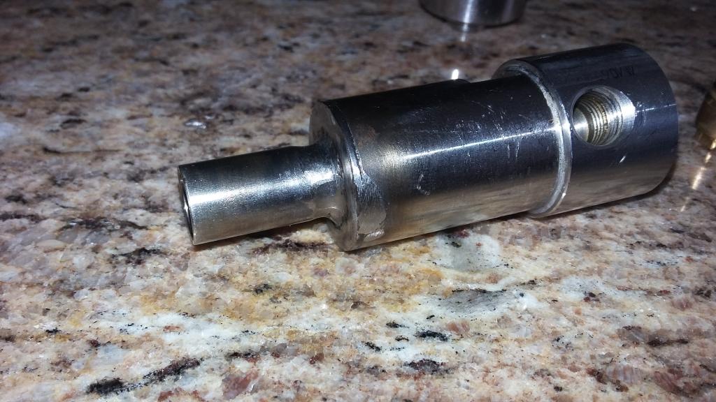

    Luke: nice stack of dimes. I learned a thing or three watching a world class welder. It looks like good welding.
    Smallerfreeze: you could be right, that though the valve is ugly, it might still work, but more to the point, that it failed before, you have no history of who did the work, the previous owner wants nothing to do with it and because of the pressures associated within the dump chamber itself, it failed once, it can fail again. If the valve was something ultra rare, ultra unique then it might be worth trying to repair it. But a minimag valve, even early on, is not uncommon, nor better or even worth more than a regular classic valve.
    You have a good standing offer to not only replace a possible hazard, but at no cost to you (shipping washes out). We in the community would rather meep you alive, uninjured and shooting a mag. It may not be the one you purchased, but you will be able to enjoy it none the less. This is not any ill will towards your intelligence or experiences, but from everyone here, who has seen this is in total agreement to not even put air to it and see if or when it will fail.

      Is there any reason the OP can't take Luke's advice to simply thread a new powertube on? This eliminates the weld but let's the OP keep/use the remainder of the valve?

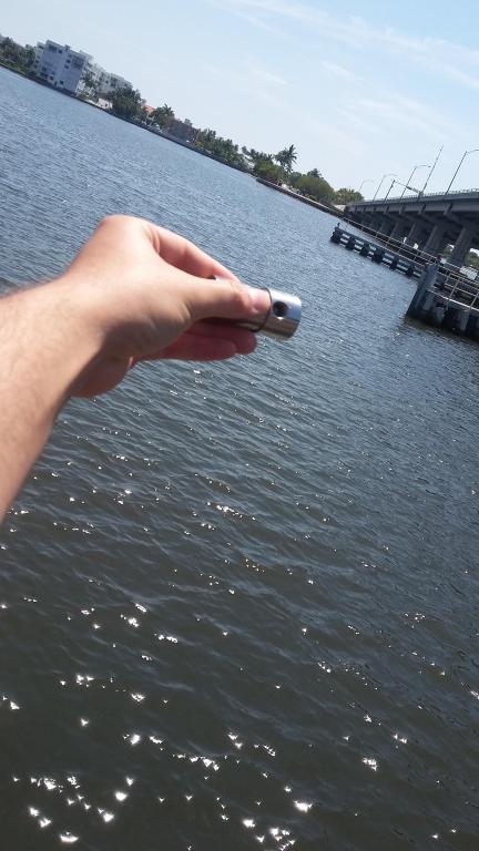

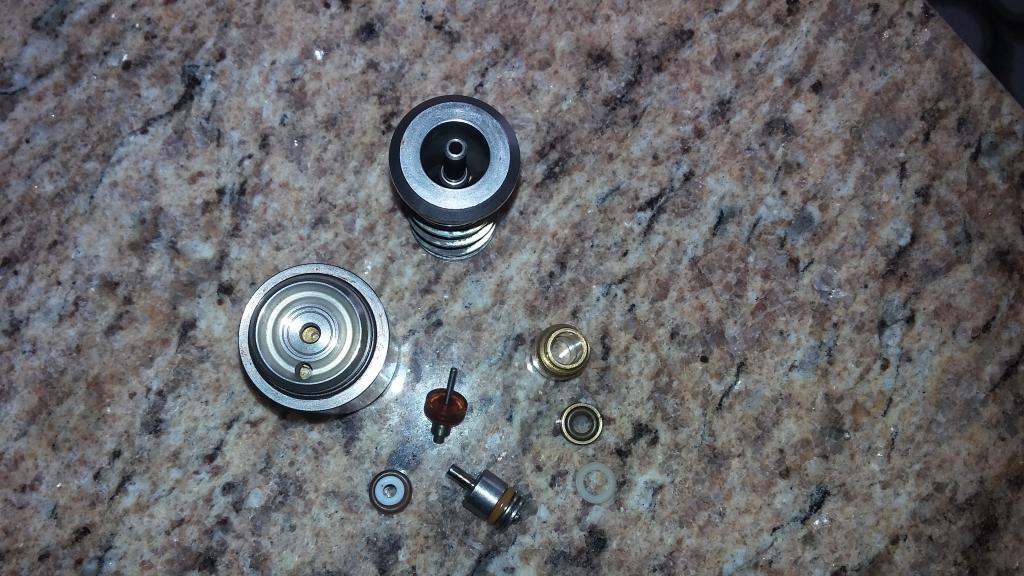

                    1d68FgM.jpgGNAjUoO (1).jpgXZUpgcP.jpg ... i took tunamans advice on the lagoon RIP danger valve.. everything else looks good

                      #40
                      Originally posted by smallerfreeze View Post
                      [ATTACH=CONFIG]93823[/ATTACH][ATTACH=CONFIG]93824[/ATTACH][ATTACH=CONFIG]93825[/ATTACH] ... i took tunamans advice on the lagoon RIP danger valve.. everything else looks good
                      Had i seen the weld going out to the threads i would have said the same thing.
                      • nak81783
                        • Nov 2001
                        • 782
                        #41
                        Ah, yes. There it is.
