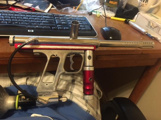

    Hey guys,
Name:	Classic Mag Pic .jpg
    Picked up this classic mag for pretty cheap... it is VERY similar to the one I sold when I was 18 after spending a ton of money (at the time) upgrading everything (in other words... it is the one that got me to fall in love with them... and it got away)... Selling that mag was when my life went all wrong...
    Anyways... working on bringing it back to life.
    Changed the piston O ring this evening... and replaced the on/off with an RT one I had laying around (because it had good o rings)... and also put in a fresh reg seat... it has the ANS 10 hole bolt...
    basically the only o rings that haven't been changed are the reg body o ring... and the power tube tip o ring.
    When I air it up I am getting a leak out of the bolt... and it won't cycle... but pulling the trigger does cause the leak to stop.
    I am thinking maybe it is the spacer in the power tube... maybe it needs a different size. Not really sure. Been a long long time since I've messed with a classic valve.
    Any thoughts? I kind of expected when I changed out the on/off and replaced the piston o ring I would be good... but doesn't seem to be the case.
    Armando

    Oh... and anyone seen a rail like this before? Seems like on of the TASO aftermarket ones... but you can see someone milled a slot in it...
      A leak, upon airing up stopping when trigger is pulled is the powertube. A leak that doesn't stop at all is the on/off. Other than making sure that there is enough lube in the gun, it should be the powertube oring. It may look fine, but a leak is a leak. Thus you need a new oring.

        I put a new powertube o ring on there since that original post and it still leaks... I noticed though... when I screw in the tip... there is a gap... I recall when screwing in the tip there used to NOT be a slight gap.

            The o-ring that goes on the powertube tip and the one that goes in the powertube are two different size o-rings. I would buy a spacer kit and go from there, or pick up .220 spacer. What size spacer is in there now?

              Oh ****... that is probably the problem lol.

                There is an o ring that goes under the spacer... which is completely missing...

                  That is the powertube oring. There is no powertube tip oring in the parts kit. That is a static oring on the tip and should basically never need replacing.

                    Hey guys... got my hands on a powertube o ring and she is shooting nice!

                        Now. Do not take the Valve halves apart until it craps out again. This will keep your reg seat good.
