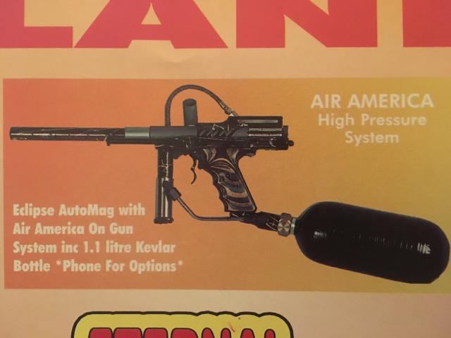

    Hi guys,
    Back in the day we used to run the classic mag with an on gun Unireg as a front grip, the high pressure air bottle was 3k I believe with a brass thumb turn on/off valve like in the pic:
    With a classic, running a triple reg system will starve the gun. Add in that with a Unireg, more stainless steel does not makenit any lighter(subtraction through addition). I would bypass the unireg/foregrip and run from the tank to the valve.
    To fill it, i think you would run an ASA with a bottomline, so it could depress the pin valve and full it that way. But i am totally unsure. I do not see any advantage of that to today's better HPA options.
    As for the unireg itself, you can simply run the line past it, gut the internals of the unireg so it is inoperable or, open it up(i.e. run the reg totally open at its highest range) and just adjust pressure at the A.I.R. valve like normal. Double regging with co2 is near ideal for consistency, and even practical for HPA, but adding more to it will only have flow problems and that is no good.

      I Think he's referencing that specific bottle in picture that had no reg on the tank itself and was more of a co2 style output of all 3000 psi.

        Hi,
        Thanks for the replies!
        Yes so I’d be wanting to keep the setup as original as possible, like in the image. My recollection is that this early air system was a 3k bottle with on/off valve (but no reg on the bottle) that was the purpose of the Unireg as front grip, it must have regulated the bottle pressure down to the AIR valve input level.
        Is that right? Did a Unireg take 3k pressure and what was it’s output range? I’m having trouble finding this info online, 450 - 850psi?
        So I have two thoughts here can you give any feedback on whether these options would be considered safe and would actually work:
        1 - new air system preset super high pressure setup with reg on the bottle, would go straight into the back of the gun. Regulating to say 900/1100. Could flow through the unireg front grip either regulating down to the AIR valve input pressure (650) or can the unireg be dialled out so it acts like a gas through front grip and feeds say a ReTro valve? Is there enough difference in the reg pressures for them to function properly?
        2 - Is there a modern on/off thumb turn valve (with no regulator) that can be used on a carbon fibre bottle? There are 3K CO2 valves like this online with burst disks built in, can these be used with 3k HPA? If this was possible/safe 3K would run to the unireg to do it's original job.
        Thanks in advance for any advice/input.
        Al...

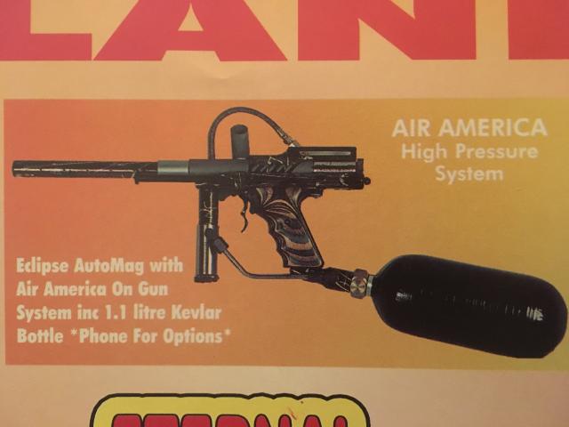

                      I’ve managed to get a front grip AA Unireg like the picture but haven’t been able to locate a manual online, does anyone have any information on this reg and it’s parts, also any steps to take to test and get one working again? I’ve read that you shouldn’t separate the reg as the reg seat will not be resealable?!
                      Any info. appreciated!

                        I have it saved on my phone but I don't feel like uploading the inages to Imgur and then posting each link. So here's where I pulled it from MCB (Vigilante or Black Ice should suffice). Key tip, never screw it in too far or you can bend the pin.

                          The ones on the mags regulated the pressures down to mag levels at about 800psi.

                          The unireg can have the guts removed so that it feeds air straight through without any regulation, so it can be used as a gas-through. You will have a minimal amount of restriction in air flow.
                          There are on-off valves that can handle the 3k required. They are heavy and bulky, and I don't know where to find them. Be aware that some of those valves were reverse threaded, so not all of them are interchangeable. The 3k CO2 bottles are tested at 3k but are set protected at 1.8k because CO2 goes to gas at about 850psi. 3k Paintball tanks are rated at 3k but are tested to 5k. They are not the same tanks.

                              Saw this last night and was thinking about it...
                              So... I started playing in 96... and worked at the local field for 4 years (while in Highschool).
                              Back then compressed air was a relatively new thing... but all the systems were filled using a quick disconnect system (like today).
                              The one relevant detail here is that I remember some guys with the old max flo (smart parts) setups... and on those you would have (sometimes) an on gun reg... that a fiber wrapped bottle with a pin valve or on/off valve would screw into...
                              The on gun reg would have a port for input (with a one way valve and QD nipple)... and an output port for a hose going to the gun...
                              Second image here is the one I am talking about:
                              I remember a couple of them would fill their tanks partially with compressed air (by plugging into the input of the on gun reg)... then they would unscrew their tank and put some CO2 in it (which to me was silly)... they would do it to get more shots...
                              That is how you could potentially fill a threaded fiber wrapped bottle with a pin valve with compressed air...
                              So basically you find one of those old max flos... and then you would have to hook that up to the fill station as an adaptor... so... you screw your tank into the max flo... then plug the fill station into the max flo... and then take your tank off (full)... and screw it into the mag.
                              Also a quick note: Why not just run a raptor on gun compressed air system? Those were basically uniregs I recall (at least when I took them apart they looked the same)... Raptor on the bottom line... and then a gas through grip.
