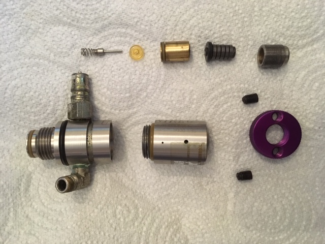

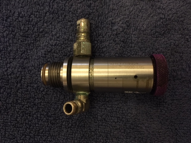

    Hi,
    Thanks for the messages! This has moved along as I’ve found an on gun Unireg (pictured). The raptor manual suggested above is a good reference, the main difference between it and the Unireg looks to be the gas distribution body, the reg components look the same (3k version not the Rex) and also look to be the same as the mag AIR valve.
    Can anyone confirm the mag AIR valve, Unireg and Raptor 3k share springpack, piston, reg seat and reg pin?
    This would also mean the raptor manual quoted output range of 200-1000 psi would apply to each reg?
    The reg distribution body on the "on gun Unireg" has two threaded inputs one from the bottom line asa and the other was used for a fill nipple. So the original setup was an air bottle with brass on/off valve feeding 3k bottle pressure through to the Unireg grip and filling was done from the reg. The one I have pictured came like that and I’ve found a friend has two set up like this with hard lines (3k rated?) running between the reg and bottom line. Any advice on 3K rated hard lines would be appreciated?
    From the feedback above I think it may be possible to source a new brass valve with 5k burst disk suitable to go on a modern 3k hpa bottle. The system wouldn't have a 1.8k burst disk but I was thinking this could be fitted to the vertical asa above the reg?
    Last question the reg pictured has two outside orings on the distribution body, I read this was for a tournament lock cover, does anyone have a picture of one of these?
    Thanks again,
    Al...
