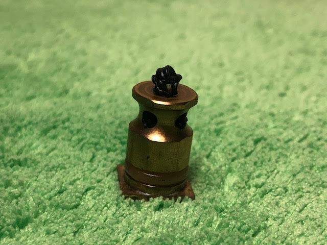

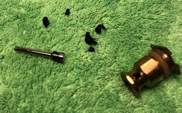

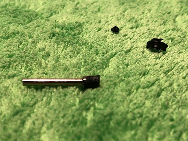

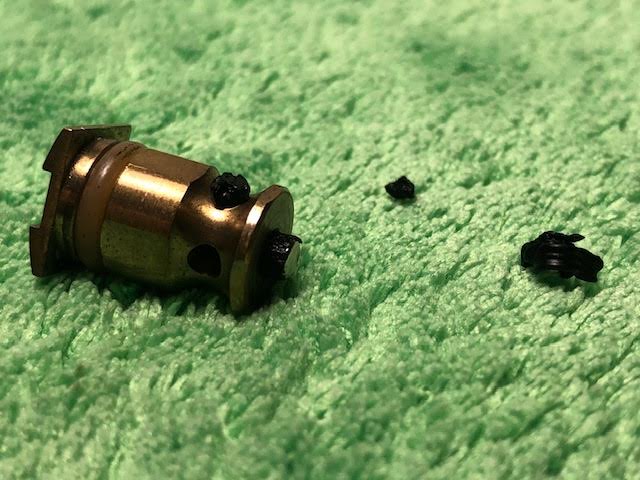

            I took 3 valves and all of them had the same issue. I'm 99% sure that it was the heat from my trunk since all of the valves were working last week at my home field. I put some new quad orings in and everything returned back to normal. For any traveling e-mag people, remember to store your valves in a cool place.

                  Yes AGD quad orings will deform under extreme heat. Not exactly sure what the specific amount of heat is, but it seems to be attainable in a hot car...
                  I've seen many deformed and melted in the on/offs just like Bunny has. Also seen them become deformed in storage due to heat.
                  They seem to be much more susceptible than the nitrile buna or cast urethane.
                  Unfortunately I don't have the specific temp specs on our quads. I just did a quick search and cars can reach 172 degrees inside if temps reach 100 degrees outside.
                  Obviously the quads are melting somewhere above 100 degrees and below 172 degrees.
