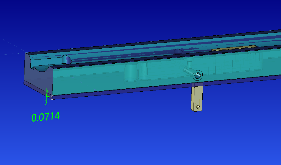

                  • 8211
                  #23
                  This is an overlay of the RTP and Hybrid rails, the only spec difference between the two is the .0714" BELOW the sear pin. The proper spec is maintained between the sear, on/off, bolt, and body. I have compared my CAD to the AGD CAD files and they are exact where it matters.
                  If these rails or anything I do pisses you off, hold my beer because I'm only getting started!
                    [ATTACH=CONFIG]101195[/ATTACH]
                    Paging Nummech to the "Luke Rail Spec Debate" thread... Paging Nummech to the "Luke Rail Spec Debate" thread

                      #25
                      To be fair, it's just as fair to say Nummech isn't compatible with LC rails. It's a two-way street and and that incompatibility can pretty easily be fixed by Nummech. The sear design on hybrid rails is a design choice, not an oversight.
                        • 8211
                        #26
                        The Classic AM sear sits below the bottom of the rail too.
                        Neummech and I have already discussed this, he said he was going to make adjustments on the next run of frames if he makes more.

                              #29
                              If it matters, then the geometry to the trigger would be correct and there would be no need for spacers, sear rod adjustment, nor you to fix anything to get good, reliable parts.

                                I think I understand why you're frustrated, but I think you're perceiving Luke's design choice to be a bigger issue than it is. Yes, everything north of the sear pin in the sear assembly MUST match AGD spec otherwise you're going to have serious issues. But the hybrid rails are fully complaint there! South of that sear pin however is a lot more flexibility. If there wasn't, then you'd never get a Benchmark frame to work. Benchmark frames reposition the sear rod in a rather weird orientation and often/always require a sear rod adjustment. Ever seen any of rawbutter's modded frames? None of those frames are even remotely close to AGD spec, yet they still work. There's a lot more room to play around south of the sear pin than you may realize.
                                The only currently incompatible product, at least that I know of, is the Nummech frames, and it's not fair to blame that only on LC. Both products are aftermarket and neither designer can be expected or responsible to know each other's design. Nummech's frames have a narrower gap than AGD frames. We're not calling foul about that. Both manufacturers have already talked and worked out a solution for products moving forward.
                                Instead of hating, can we not just applaud both Nummech and LC for making cool gas-through frames and automag-height RTP rails? This community is small, and I want to see it grow. Discouraging innovation isn't going to help us grow.
