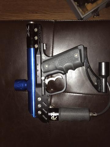

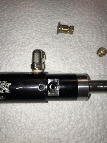

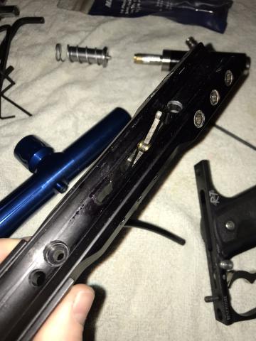

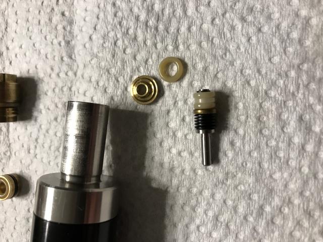

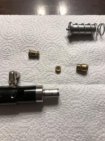

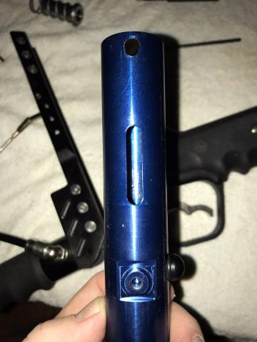

    Original set up as it came from factory
    Lvl 10 set up
    Smallest carrier
    No shims
    Longest spring
    Thanks!

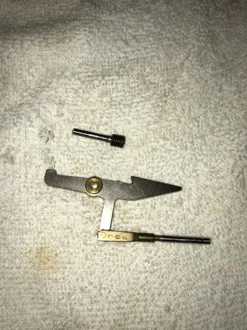

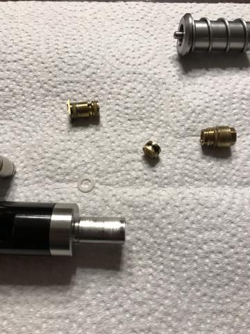

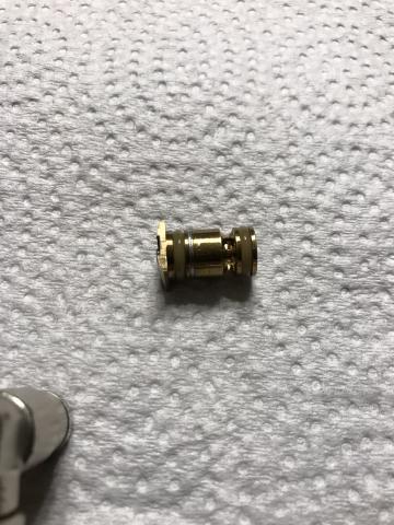

          Update, I noticed the brass shim for the field screw was missing from the marker so that was part of my initial problem. Now that that is in the marker fires normally but still have a small leak for the ULT on/off valve I believe. The reason I think it is the on/off is because I tried the on/off from a minimag and the leak stopped but the trigger was too reactive (run-away).
          The ULT has 5 shims in it, I tried it with 3 and 4 shims and replace the bottom white o-ring but that did not solve the leak.
          Also correction on my lvl 10 carrier size I have a #0 and for some reason that is the smallest one in my kit.
          Here is a video of my problem, as you can see the leak stop when the trigger is pulled.
          Again any help would be very appreciated!
          Thanks
            • 8367
              • 8644
              You have to get rid of the long spring. These guns are too finicky using that spring. Use a red or gold spring and your carrier wont need to be so tight. There are 2 more smaller carriers now. I have them if you need them.
