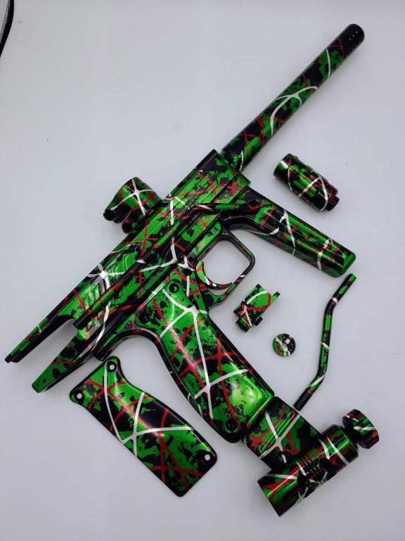

              Or you can pick up a Lc Micromag, I'll be glad to answer any questions you have on the Deflator.
              The Deflator design was the MM2K9 that I wanted.

                Concerning the PTP MM2K9 bodies, I'm still guessing one of two things:
                1. Bolt spring is over-compressed when installing valve. This pre-over-compression prevents higher velocities. Similar to installing red or gray spring on Level 10 without turning in the velocity adjuster to compensate.
                2. Bolt releases air too far back in stroke. Too much air is lost up feed tube or elsewhere to propel the ball at higher velocities.
                Or perhaps both. They may be connected. But I only have second-hand info to go on. I've never owned one. I just don't like the looks enough to veer from AGD products, which work (or have a large support network to get them to work when they seldom don't).

                  OK, I'll try again 3? 5? years later. What dimensions differ on the Deflator vs. the MM2K9 that allow the Deflator to reach higher velocities than the MM2K9?
