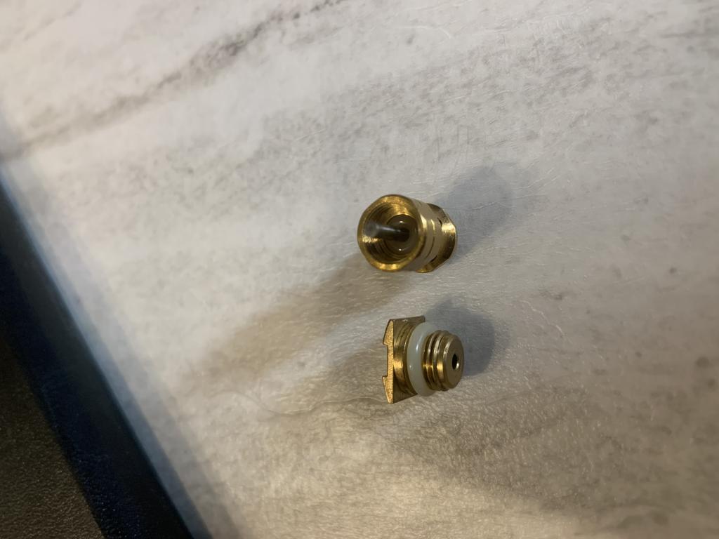

            • JMG1955
              • Oct 2021
              • 7
              • JMG1955
                • Oct 2021
                • 7
                They're there, just not pictured, up in the valve.
                  • 8648
                  Check the pin to make sure it didnt break also.
                  • JMG1955
                    • Oct 2021
                    • 7
                    Its .75".
                    Everything else seems okay.
