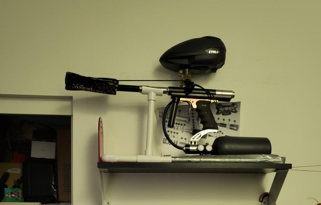

                        Can you post a picture of the marker, it might help to see the full setup?
                            It's not the best picture but it's what I have on hand at the moment. My partner is at home so I can have her take another picture if this doesn't show what you need to see.
