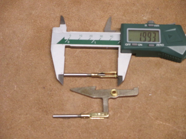

                                Have you addressed the other problem with the sear rod length?
                                If you have set of calipers you should start with the Trigger Rod length at 1.985" but it could need fine tuning with the aftermarket trigger. The measurement is less relevant than the actual gap measurement, you need about 1/32"
                                You measure the rod assembly itself, you dont need to remove the rod from the sear, this just illustrates the two measuring points.
