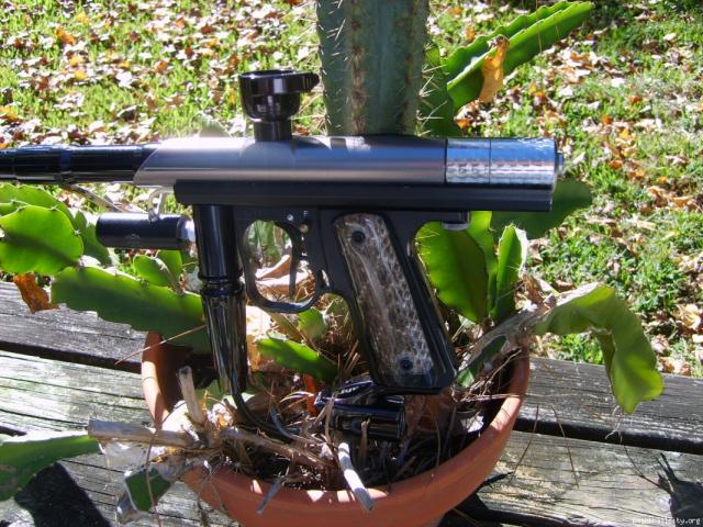

    Here's how the guts fit finally.
    The switch is an 80g switch that I bought a bunch of to replace timmy board switches (that never needed it). Due to my frame's previous uses, the switch mount didn't come out clean, but the idea was to drill a hole of a diameter that would just fit the switch and pin the switch through, with the hole on the edge of the frame so that a slot would get cut for the wires to come through. I couldn't get a bit to run straight in my press on my carved up frame, so I drilled it by hand.
    Not only does this give my classic valve a home, I now have an x-valve to put in the next project.

                  Well, shot count is somewhere over 20k. Still rockin' with a palmers micro lpr. Gone back to the teflon on/off o-ring and compatible pin since the quad o-rings just fell apart in storage.
