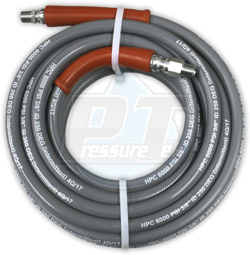

                  I was looking at the 4500 psi capable hoses and they are not that cheap. I've found some for $60 and up and nothing on paintball web sites.
                  This one was the cheapest I could find:
                  Discover the HPC 6000 PSI Pressure Washer Hose, designed for exceptional durability and performance in heavy-duty cleaning applications. With a robust, abrasion-resistant cover and heat-resistant inner tube, this high-pressure hose ensures reliable operation and flexibility under extreme conditions. Perfect for commercial and industrial use.
                  Would that one be a correct hose to be used for this application?
                  Also, would the standard quick disconnect fittings we usually use stand that pressure?
                  Please advice.
                  Thanks,
                  Mendel.

                    ninja makes one (previously mentioned)
                    • mpsd
                      Crazy Brazilian P8Baller
                      • Nov 2005
                      • 2778
                      #55
                      Tom said it wouldn't be safe to use it because of the time under which it would be exposed on such high PSI, didn't he?
                      • slick86
                        • Jan 2010
                        • 13
                        #56
                        didn't see that, just needs two female ends.
                        Ninja sells a 3000psi one
                        I'm sure they will sell the 4500 ones if enough ask imo
