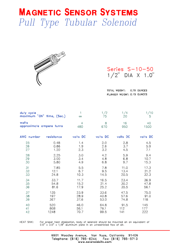

    the Old noid would not work on the 9v, I ordered the same size noid from the manufacturer that wired for 9v instead of 14v like the stock noid. It worked, but the RoF was low, it was too much for the cap and 9v to handle over maybe 8bps.
    Here's some specs on the Noid I used.
    Tubular Solenoids, DC, Pull - Worldwide Delivery of Electromechanical Components from Los Angeles, California - ElectroMechanicsOnline.com, Van Nuys, CA
    "P = Pulse (10%) Duty Cycle, Maximum On-Time = 5 Seconds
    Approximate Input Power = 40 Watts
    Force at 0.05" (1.3 mm) stroke: 25.0 Oz (709 gr)
    Force at 0.10" (2.5 mm) stroke: 15.0 Oz (425 gr)
    Force at 0.25" (6.4 mm) stroke: 6.0 Oz (170 gr)
    Force at 0.375" (9.5 mm) stroke: 2.0 Oz (57 gr)"
    as you can see the ULT is a must with the force this thing puts out. I haven't measured the distance I have it pulling yet I'll do that and let you know but My air is below 1k after the test fire video I'm not sure it will cycle
