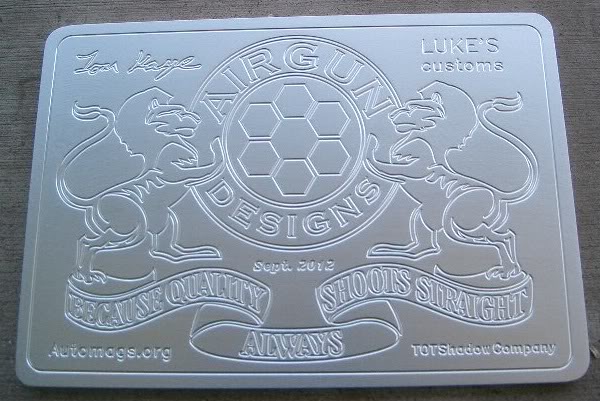

    6061 aluminum 1/4" x 6" x 9" (approx) cnc machined not laser engraved.
    The back will be machined so it can be hung on the wall.

        Here is a suggestion.. can you powder coat them first and them mill it?
          The powder coat would probably flake but one could anno it and then mill it and it should work.
              I thought about that too but it would indeed flake. I was thinking perhaps applying powder to the machined surface then removing the powder off the face leaving it in the groove, but that would be real tricky. Not sure how clean the finished product would be.
                Anno would actually work after machining. Anno the part then lay on a flat level surface, apply dye with a syringe into groove, rinse and seal...

                              • 8248
                              Guys, an anno guy should have no problem anodizing these. The "coloring" of the anodized part is just a dying process that can be controlled. The dye can be applied with a syringe into the groove so it can be a different color than the face.
                              Sending you the plates before the engraving creates more work than you realize.
