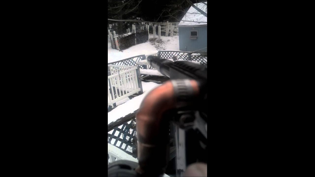

    Ok so I was bored and decided I should hack up a loader :what:
    Damn compared to the halo line the z2 has no room for this. Cut down the elbow and had to thin it down a little more than half of the material to get it to sit in the existing Raceway as I wanted to cut the z2 as little as possible.
    Had to notch the battery block to get it to fit will look into other power options later
    Almost there!
    Now I just need paint to test run in. Notice the motor is the same size as a halo one so might get some high torque motors depending on how the stock one holds up.
    First try and works great. I had nothing but old paint. I will try to get some fresh stuff and kick the rof up in the next video.

        could you post pics of how easy to remove the front is for cleaning?

            I will when I get home but the elbow coming out of the loader is not secured on inside the loader. Instead it is sandwiched with the bracket at the bottom and the warp body at the top. Loosening the clamps at the body and the elbow slides right off and then the nose can be removed as any other z2

                I did it on a halo 2 and it worked great. The key with the halo is you have to use a upgrade to the motor

                    Ummm
                    1 z2
                    1 3/4in 90 degree copper elbow flanged on one side
                    2 3/4in 45 degree copper elbow. 1 flanged on both ends and the other flanged only on one side
                    Some straight 3/4in copper pipe
                    Some fix stix "epoxy puddy"
                    Some quick set 2 part epoxy

                          You actually would not need a new loader. Both the halo Raceway and the z2 come apart where the paint feeds towards the feedneck. 3d print a new piece that diverts the feed path up.
