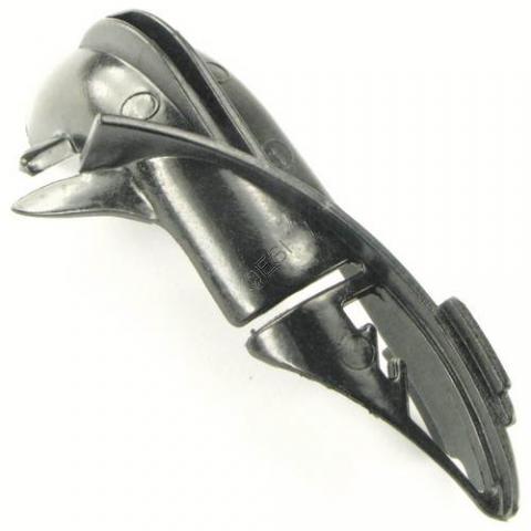

            The first is the "slide", shown here:
            The slide allows the paint to feed downward. It would need redone to cause the paint to feed upward.

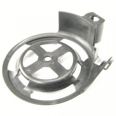

            The second piece is the "outlet cover", shown here:
            The outlet cover mirrors the original slide, and also contains the anti-jam freeway. It would need redone to cause the paint to feed upward.

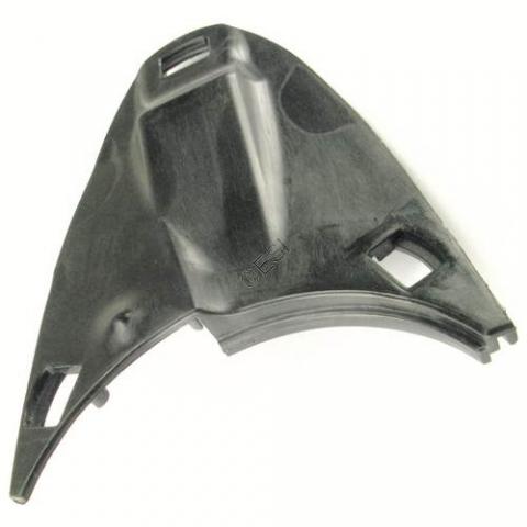

            Ideally, those pieces could be formed into one 3D printed part and would be angled at about 45* toward the right-hand side of the shell to accommodate the mod. Then, to make the system really drop-in, a new floor could be printed with a hole in the proper spot, to allow the newly printed slide/outlet cover to fit through. Or, of course, you could require people to just drill a hole in their existing floor at just the right spot.
            Here's a pic of the "floor":
            Once this is done, the internals would be modified for upward feeding, and all that would need to be done to complete the mod is to drill a hole in your shell of choice (normal/high-cap/whatever color) and feed some warp hose through. The warp hose would need to fit over the newly designed slide/outlet piece, snugly, just like it does with the newer qloader 90* angle connections like I posted before.
            If someone were really interested in redoing these parts and having them printed, I'd be super interested in purchasing them to have a perfectly clean mod done. If not, then copper pipe and a dremel it is!
