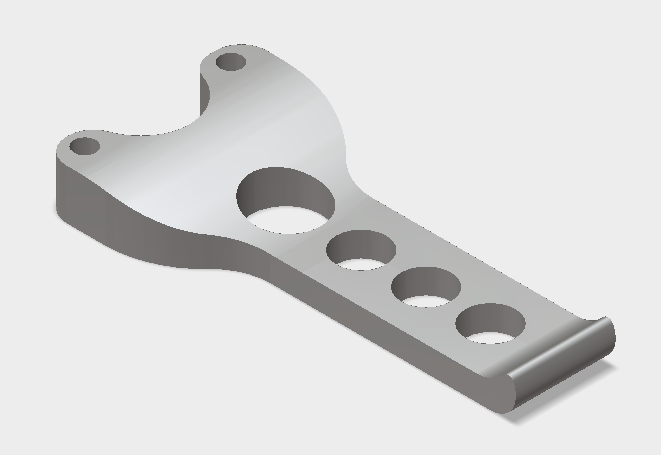

      I have a question about other printed items. Working on a pump build at the moment, and I'm scrambling to find a hitman mod for it. The thought struck me... Can such a thing be printed?
      Here's a rough sketch of what I came up with:
      I have a feeling what I've sketched up probably won't last long; the two small holes where it mounts to the pump plate are probably going to break through, right? The cutaway between these two holes is necessary because of the pump rod that is between (and slightly below) them. BTW, the overall length is 2", width is 1" at the top tapering to 0.5" on the handle and thickness varies from 0.25" where it mounts down to 0.125" on the handle.
      Thoughts? Can it be done KNM?

        That's printable, but it won't be strong enough to use as a pump handle.
        The best possibility would be to use 3d printing for the tricky geometries, then augment with off-the-shelf parts for strength. So 3d printed parts + off the shelf CF rods = KABLAM. Personally for anything pump rod/handle related, I'd look at some actual linear bearings and build around those if possible.

            yes it will.
            may need small tweeking but should work fine.

              yes it can be done.
              * again small tweeking but i could get you where you want to be.

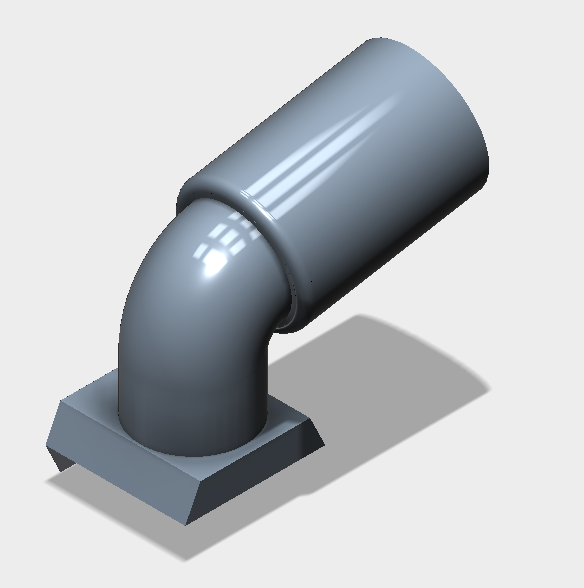

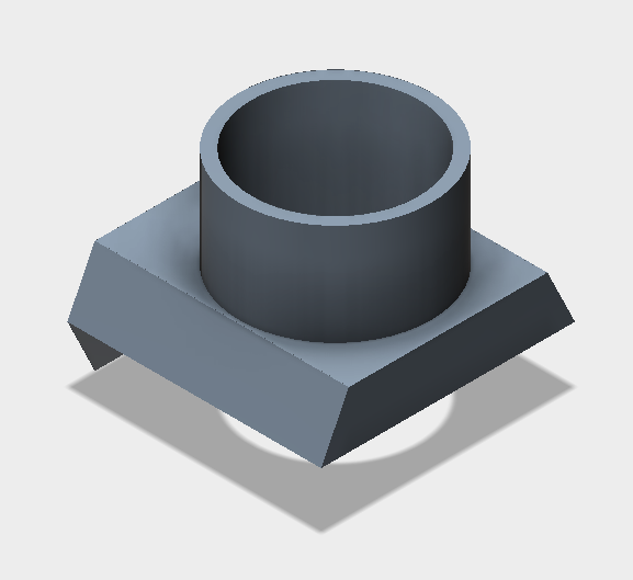

                                Got another crazy printing idea that may just work. If you pay attention to my blabbering, you may know that I just "finished" a Z body pump mag. By finished I mean made it functional, and it's a whole hell of a lot of fun.
                                An idea struck me. What about making a "classic feed" for where the powertube attaches. The body uses as a dovetailed, removable powerfeed setup. If I can go with a classic feed, I can easily bolt on a very low profile stick feed. Biggest problem is that I'm drawing up a product with a market of one buyer (I think). Then again, I thought 3D printing was all about the capacity to do one offs and rapid prototypes?
                                So I took to my free CAD software and came up with this. I'm pretty sure this is a printable part, no?

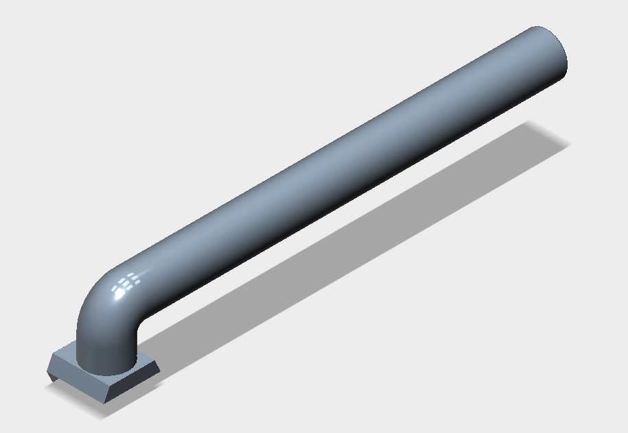

                                I also made one with a fully revolved and extruded 12 round tube, but that might not be possible to print because of dimensions and geometry? See below.
Name:	Z Bod Feed 2.png
ID:	2183860Click image for larger version
Name:	Z Cram Jam.png
