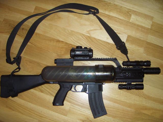

    I'm in the process of building a mag and want to do a q-loader setup. I'd really like to do a warp left body and have the loader direct mounted and pointing down the side going back, like in the picture. I understand mounting may be an issue, but is there a way someone here knows of that I can secure the loader in this position on a mag? I do not wan't any hose or to have it mounted anywhere else going in any other direction.

    I've never been fond of this setup for a lot of reasons, not the least of which is the fact that you're reloading into your face.
    The problem is pretty much all the AGD bodies/rails are not made with modding in mind. (Neither are the Q-Loader sockets for that matter.) Closest would be a Tac One, and even then picatinny bits still aren't in the right place for this.
    Easiest and dirtiest way to get this done the way you want would probably be to "attach" (*cough*) a side picatinny cowl/shroud to the body, then use the "RIS Rail Adapter" to mount the Q-Loader to the cowl.
    Or glue a mating cowl piece to the socket and slide that into place.
    Remember where your air line is as well; depending on which side you want the Q-Loader on, you may need to reorient or get a reverse valve.
    And also note that the breech on an Automag sits further back than marker like what you've pictured. It sits pretty much over the trigger. Since you want direct feed, that means that's where the socket is. So imagine moving that entire assembly backwards.

      Thanks for the response. I had considered the fact that I may need to go with a tac body to achieve what I have in mind. It looks like if I were to get that adapter and the q bracket that points forward, I should be pretty close to where I want to be with a little modding necessary. As for the air hose, I'll be using an AGD back bottle asa. No prob there. If anyone had any pics of mags with a similar setup, I'd love to see'em.

              I'm pretty much with cockerpunk regarding opinion towards the q-loader. I made a great set up where my pods loaded in front of the trigger like an assault rifle magazine. Then I played a day with it and decided it wasn't for me.
              Filling each pod was quite time consuming. You'll miss being able to just dump your paint into a hopper and go. With 5 pods to fill, making it in time for the next game was a real issue. A tip; use a Revi as part of your q-pod loading apparatus - it will be invaluable. Filling q-pods was troublesome. They often jam in middle of filling with the crank, necessitating the need to unload and try again. Forcing it any further will break paint inside the pod. Cleaning broken paint out of a q-pod requires complete disassembly and is very time consuming. I also found that q-loaders are harsh on paint. Paintballs got smashed in the chamber sometimes due to the force of the spring. Preloading paint in the chamber helps, but it won't eliminate the problem completely. Removing the hopper from the top of the gun was cool, but you don't get something for nothing.
                By the way, I have a q loader for sale. Been sitting in a box for 7 years. Only used once.
                Hmm. You've given me much to consider. I've just always been opposed to some big dumb thing swaying back and forth on top of my gun. Loved my reloader B I had, but never warmed up to the idea of hoppers up on top like they are. I may have to conform because I require a large capacity and I require a mag
                BTW, I LOVE your gun, Ghost. I'm building one with a lot of the same elements in mind. Voted for ya!
                  I wouldn't go with a Tac One body; I believe the picatinny is still in the wrong place, which doesn't do you any good. You would have to make a secondary adapter, and if you're going to do that, just go with a normal cylindrical body and fit a cowl over that which either has picatinny, or some other way to basically adapt the q-socket to the body. (Another way to look at it is finding a way to fill the gap between socket and body.)
                  Not sure if I recommend your mounting location though; I think it's a bit high up. Affects gun manipulation.
                  If you are locked to a classic rail, is it notched for Warp feed?
                  Reloading pods takes maybe 20-30 seconds per pod if you use a hopper to feed it, minus the time it takes to fill the hopper. So the cadence is fill up the Revvy or something, fill 2 q-pods, reload the Revvy, fill next 2 pods. During dead time I pre-loaded extra pods just in case as well. So I've never missed games due to "loading issues".
                  It's a matter of mechanical aptitude, and honestly Q-Loaders aren't for everybody.
