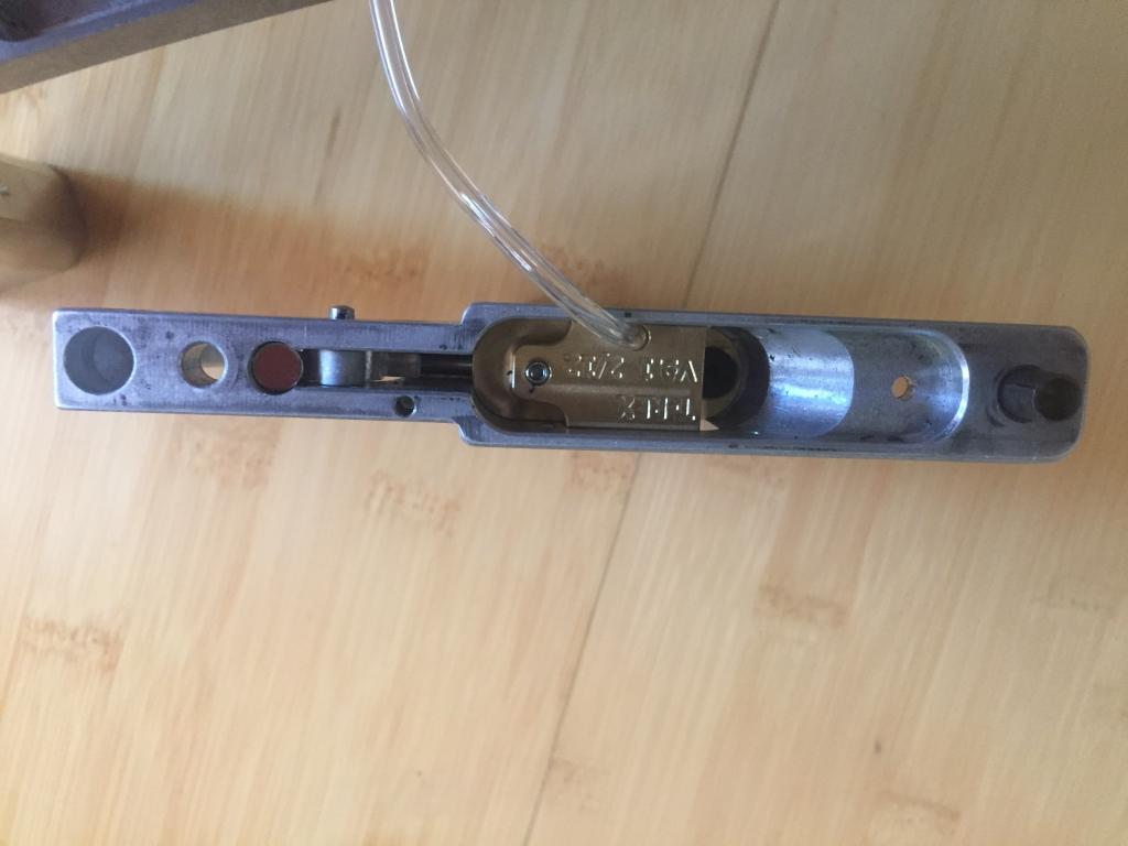

            So here's what was just dropped off in the mail...
ID:	2184517Click image for larger version
            As a testament to the quality of Luke's stuff, and also to my title of worst airsmith ever, I aired it up the first time without remembering to put in the sear/sear pin. I don't know how many times it'll take me to learn that lesson. Anyway, after some scary rapid fire, re-assembly and testing, the OLTR worked perfectly. And man is it sweet.
            Made a slow-mo video of dry firing as well, for those who are curious:

              Thanks for that video, it clearly shows the "built in" trigger stop.

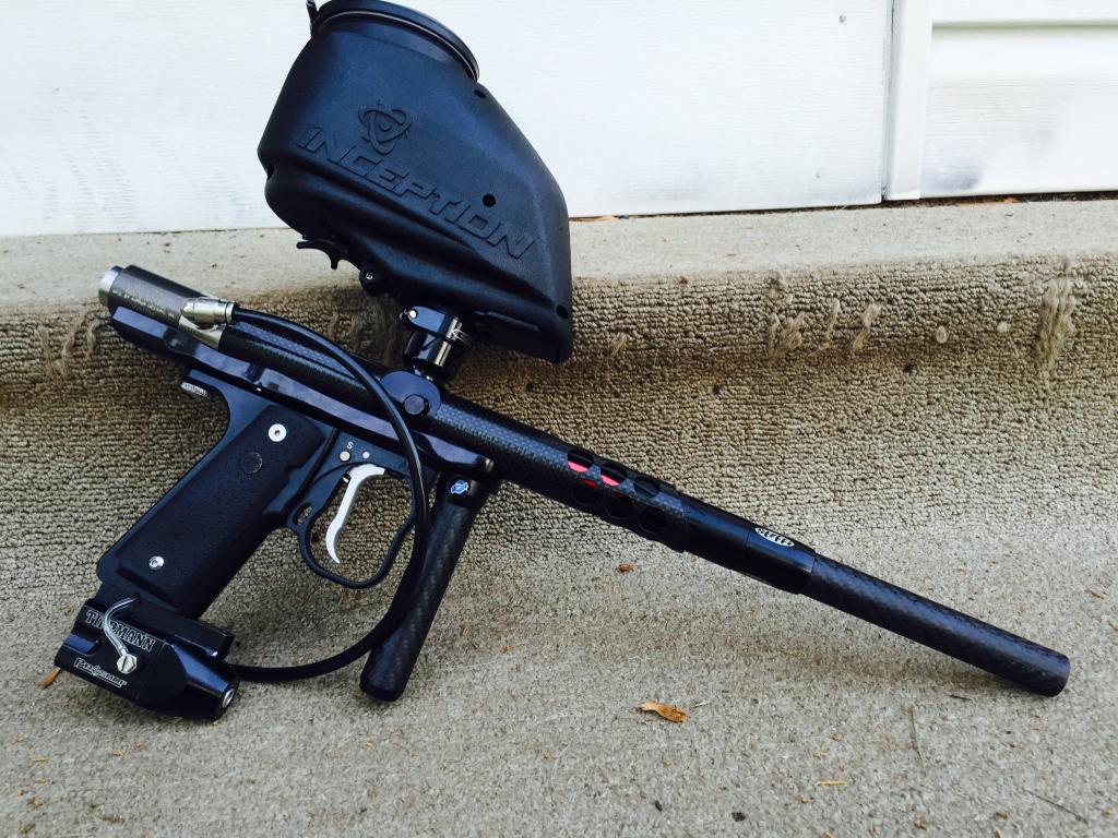

                So here is my review so far of the OTLR Valve. It shoot amazing, trigger pull is very light and controllable.
                On the intelli frame it would be nice to have trigger stops to help fine tune the pull. As you can see in the video the valve rips. Is tested the valve on a few set ups, it by far worked best on the my retro valve setup that has the lvl 10 tuned great.
                The setup is nice and simple.Click image for larger version

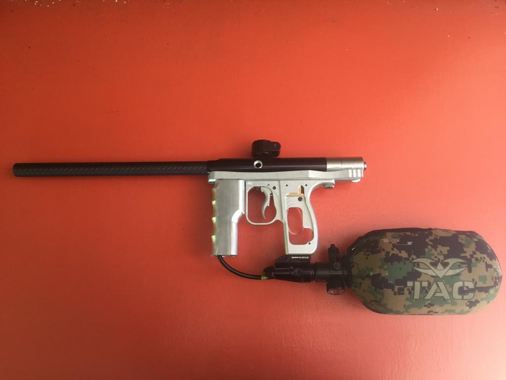

                        I did some more testing today and I think I got it just how I want it.
                        I'm back to using my X-valve. While switching between valves I noticed that the on/off oring in my classic valve was a little looser on my on/off pin. So I went to my oring kit and took all of the orings and fitted them on the pin and took the one that fit loosest. I was able to turn down the LPR slightly and the trigger seems easier to walk now.
                        With a 800psi output tank the trigger is nice and light and snappy with no RTing. When I put on my 1000psi output SHP there is a little RT but it is easily controllable and the trigger feels the exact same. Other than trying a different trigger I have it just how I want it. I'm interested in seeing how somebody who can walk a trigger does with my setup. Hopefully in a few weeks I'll be able to let some people try it out.

                            I think I'm getting a little faster, or at least a little more consistent. My tank ran to low at the end causing the chuffing.

                              That would certainly appear to be the case. Did you also get the longer trigger rod and tune your trigger stops a bit more, or just test valves and adjust the LPR?

                                I didn't get a longer rod but did adjust the trigger stops. I took out almost all of the over travel, both pre and post. I still left a little of over travel both ways as I seem to be able to shoot slightly faster with it rather than having no over travel at all.
                                I'm going to swing by the hardware store and see if they have the correct metal rod. I'm still on the fence about putting a longer rod in though. I don't want to move the trigger any more forward in the frame. I like having a safety but I don't need it. Maybe when I get a blade style trigger I'll do it.
