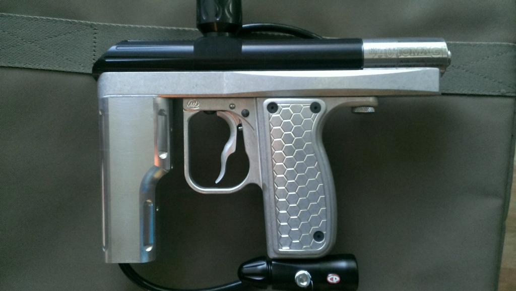

                        #431
                        Played at the field last weekend this things rips. I'm not very good at walking the trigger but for some reason left handed I got some pretty good strings together. Right handed I could fan the trigger pretty fast.
                        My setup is classic valve and rt on/off stock .750 pin length.
                        Attached a pic she is ready for anno. Thinking dust black all around. polished grips to match classic valve and a stainless dye barrel? Not into the crazy splashed anno.
