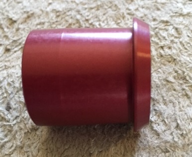

      I'm having a dilemma with the bore size for the hopper neck. The Empire neck I have will not open up enough to mount the HALO even wedging a screwdriver into the slot. My design covers the bigger neck hoppers and will squeeze down to the smaller ones (Revy) but it really puts some stress on the screw. I tried some "in between" sizes but the larger neck hopper is problematic. Not sure what to do to cover the smaller necks except perhaps make an insert for the small hoppers like CP did back in the day.
      Thoughts before I machine the feednecks?
        Was it like this?
        BTW: I like the flat top body....

          Talking about the chency plastic split ring that went around the hoppers? Ewww. I've had electrical tape on the feedback of my rotor so that it would fit my old VLbow.

            Found my old CP insert>
            Worked perfect in my old Revy>
            (I'll just make something similar and sell as an option)

                          About the feedneck...
                          Any chance to making it aesthetically pleasing? Sure, form over function, but a tube design is well rather unpleasing to the eye. Even a CCM feedneck is better looking than what you are showing.
                          Any chance to making this a lever lock? Before you say that there is too much parts required, it would actually allow you to have a greater opening spread, giving a greater range of hopper sizes it could accommodate. You could also source Empire parts if you choose not to make your own. Granted it is more work, but a lever lock type is a more modern design versus a 2 screw design. Its almost a standard feature on any new gun.

                              I'm not 100% satisfied with the mechanical aspects of this design over all. I wont argue aesthetics because everyone has different tastes, but the function is not something I will sacrifice just to get it done. Anyway I'll have to rethink what type of feedneck I want to make, but in the meantime I have lots of other stuff I can be doing. I'll revisit this towards the end of the project and just move on to the next phase of the project.

                                is that portion of the feedneck something that would fit the empire necks?
                                I ask because the adapters that someone here made a while back are now very difficult to find, but still very useful for springfeed projects.
                                If I can mount an Empire springfeed on that feedneck part, I'll buy a few of them and I think many others would too.
