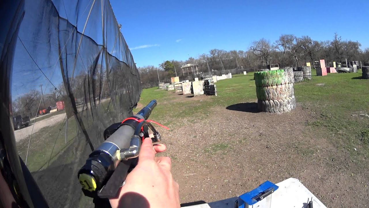

            So I was testing the magmagwell this weekend and also experimenting with a brand new way to play paintball:
            The thing worked great except for one thing: I chuff twice, both on the 10th shot out of the magazine. I was expecting this but hoping it wouldn't manifest. But it looks like I should address it.
            It's not really the adapter's fault, as the next picture illustrates:
            The follower is curved, which is usually good, but in some situations, it actually locks the last round into the curve instead of pushing it through.
            It's not a huge deal; I have 3 possible solutions to this, none of which are mutually exclusive (so I could hit it with all 3 if I want), but just something to adjust in the next revision.
            Otherwise everything works about as well as can be expected -- including the anti-dropout detent. I still lose 1 ball in a mid-mag change because my path geometry isn't exactly correct (fixable but I don't think I will bother), but in testing that 1 ball drops and clears completely out of the way and poses no threat. That still leaves 1 in the chamber and 1 in the pipe which will get stopped from rolling out if I do tilt the gun the other way while reloading.

              Was able to shoot this setup this past Saturday and I must say pretty dang cool!

                    Modifying the Mk IV feed path was pretty easy, as it was a ... circle swept over a path to begin with.
                    The original was a "normal" feed path that took a ball-sized radius right angle turn.
                    I just made the radius much larger (not unlike what the parabolic plugs do), so that the ball starts turning inward as soon as it leaves the magazine.
                    That seems to do just the trick. Squishy high-friction reballs still get stuck, but regular paint pops right over the pusher. No chuffs on the 10th shot out of any of my mags today.
                    Also found out what happens if you pull the trigger while a magazine is disengaged -- the blowback is strong enough to knock both remaining rounds right past the magwell gate. So... probably don't want to do this unless absolutely necessary.
