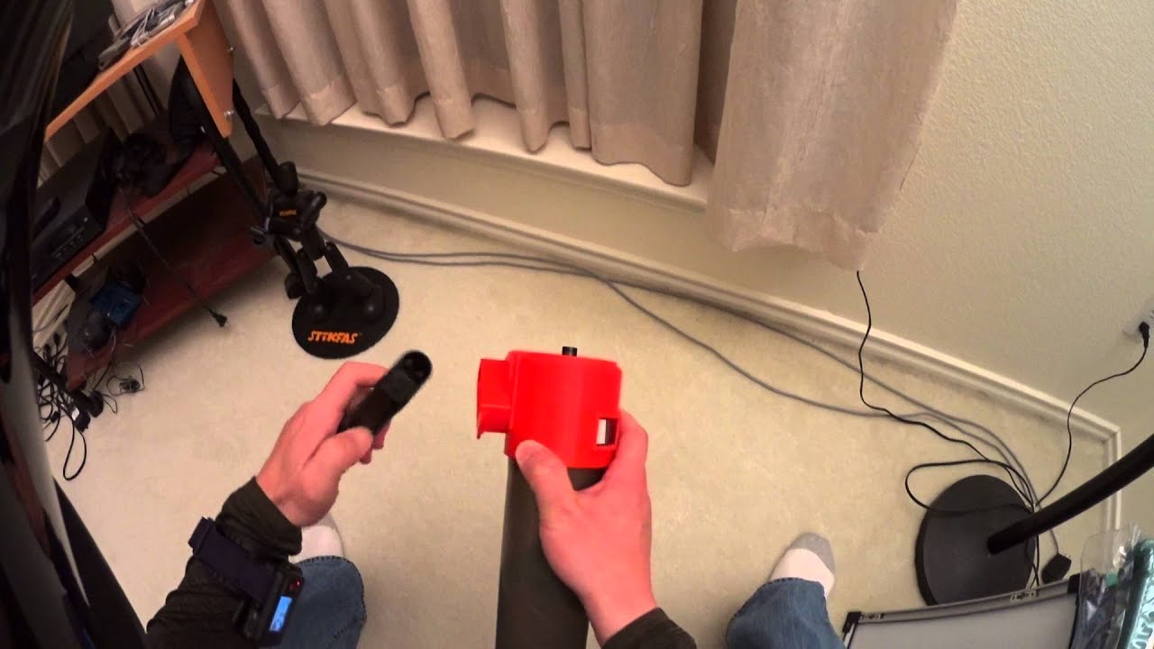

        And uh, while I'm just randomly drawing Zeta magwells on stuff:
        I had been playing with this idea in my head for a while, then I saw one of Haz Mat's videos and decided to give the idea a try.

            Actually it's a Q-loader pod with a Zetamag speedloader. Which implies 2 things:
            1. It's pretty easy to print a totally custom mounting socket for a Q-loader.
            2. A Q-loader is capable of reloading magazines in the field. Pretty sure I could do it one handed, because you know how I hates to put my gun down. This would probably be against MF rules, but F those guys.
            And before anybody asks: 100rds = 5 Zetamags, or about 14 tru-feeds. Thinkaboutit.

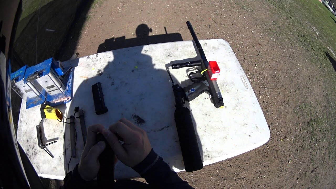

              Finally took ol' Side Feedy to the field for firing/feed testing.
              Everything worked except for one thing, and again, it wasn't the adapter's fault. The Zetamag detents are a little too aggressive and need to be sanded a bit, else the very first round occasionally gets hung up on it, even at full deflection. Once that first round makes out out, the others pop out just fine. All this... tends to indicate to me that the Zetamags aren't extensively tested against FSR's. Not a surprise.
              Only tested with 5 rds each because you know, money. But the real testing is when the mag is near empty, when the pusher spring is weakest.
              This was the first time I'd ever opened up a TPX mag and looked at the innards. I found their detent spring mechanism... humorous. Kind of sad actually.
              I was worried about the stock TPX spring feeding FSR's as they're a little soft, but they work just fine. Most of the time players try to compensate for poorly made equipment by simply using more force instead of fixing or using better equipment.
              And speaking of excuses, most conversions like this mention that they have difficulty loading if they don't pre-load rounds into the gun before inserting the mag.
              That's clearly not the case with mine -- I can insert a mag into an empty gun and fire off every shot (plungers extend enough to push the last round into the chamber) without problems.
              Again these kinds of excuses are really just a result of poor design/execution.
