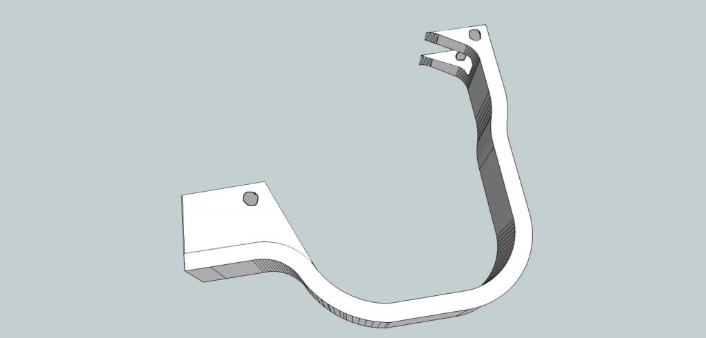

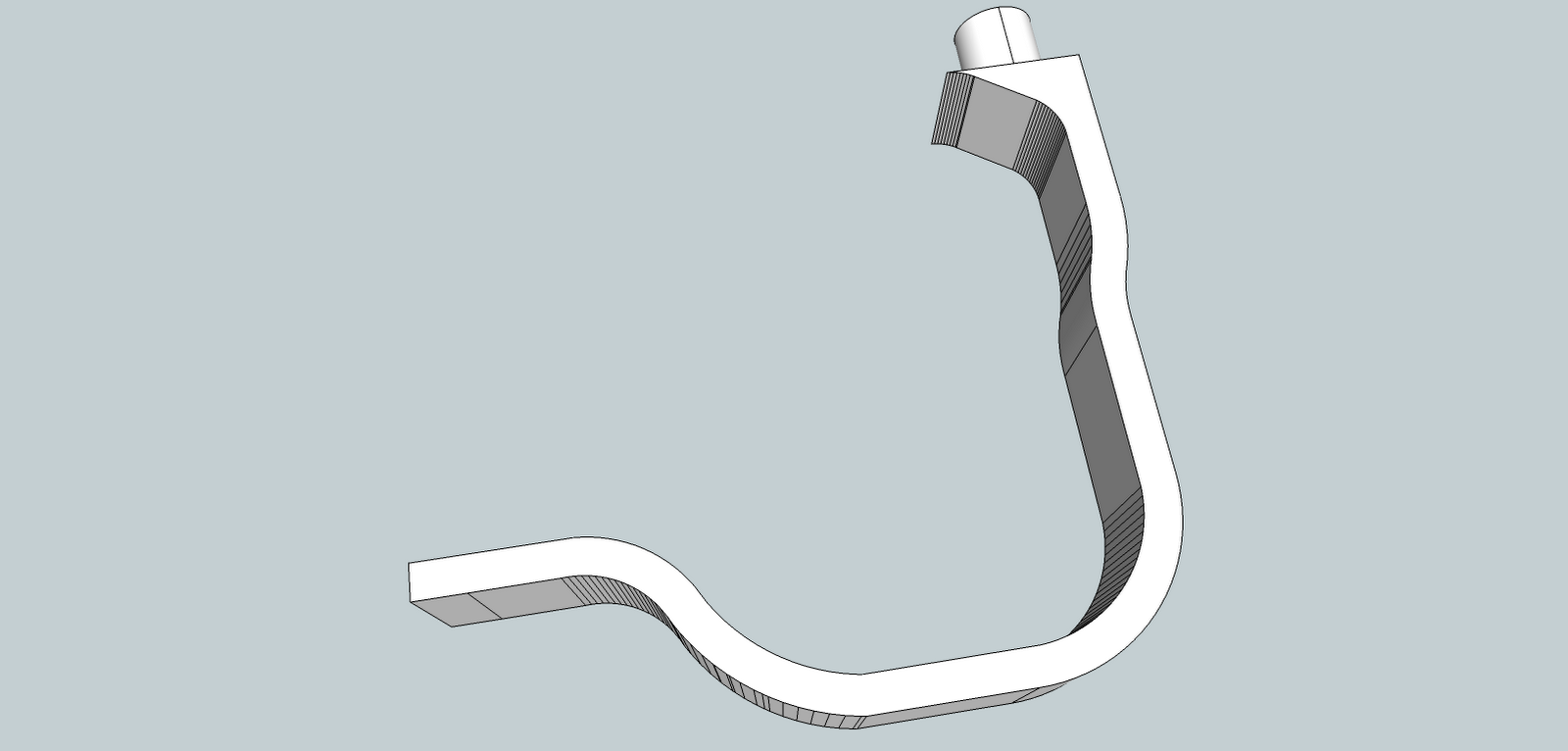

                  Oh, that doesn't look half bad. I'd personally want the lower end to meet the frame where it was cut though, just to keep the flow of things. (Or maybe make that lower end larger, like a flap going upward to meet that cut end)
                  Using horizontal pins to hold them in would allow one to keep the TL pin hole, though on the frame above, there wouldn't be enough meat, so you have to use on of the frames where people didn't cut it flush.
                    [ATTACH=CONFIG]92372[/ATTACH]
                    that design might not work depending on where the top "pin" goes...remember, the twistlock pin is in that area. you can't really have the pin going through it lol.

                      Yea lol, it'd have to go below it, not sure how deep the well for the twistlock goes, and how much room there'd be to put the pin.
                      If the pin cant go all the way through, could probably make the top part of the guard wider, and use short screws on both sides

                        I like the look of that.
                        What about tapping the frame for screws and having the new tiger guard attach right where old trigger guard was cut. I think there is enough space there to drill and tap for small screw maybe same size that hold the panels on.

                              I like that trigger guard. Would def grab one if something made it to production.
