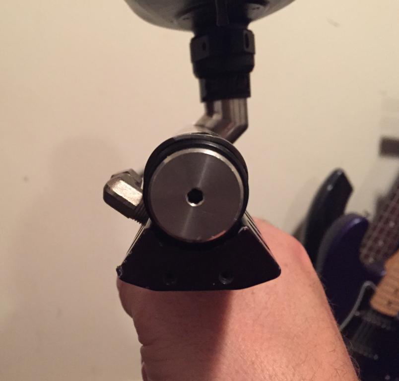

          Something I liked about Luke's old feedneck conversions was that they were low and just a little outside, so that if the loader is heavy, you can roll your wrist over just that much to balance the weight and profile. When the paint is small, you can run a gravity loader, adjust the force on the hopper, or try taping or backing up the detent. Or, you get out a ULE body mag.
          I like Luke's converted bodies, as well. Also, a dual detent RT twist-lock barrel should more than take care of any problems with small paint and forcefeed loaders.

                              AGD got it perfect with theirs so why try to improve on perfection? Why sit there and say, i can do it better and possibly ruin a body just to be different? No sir, that is a stupid "Option".
                              If *anything*, I think this is the main point. It seemed like AGD really did believe they did everything perfectly. And as such, the customers are expected to do things one way: The AGD Way.
                              And unfortunately if you thought AGD Perfection v1 was better than the superceding AGD Perfection v2, well... you're gonna hate Fridays.
                              First Strike rounds? Really? Are they even a factor anymore? Hell, are they still even legal in a majority of fields?
                              I think they got "insurance banned" at fields. I also think that it's a matter of time before they return.
                              If i wanted a FS gun, i would have ome setup specifically for that. Why try to make 1 gun a jack-of-all-trades, when you don't have to? And if a peraon is cost conscious that they might want to, then tbey wouldn't be waisting money on FS rounds. Kinda like going to a buffet to get 1 dish, and a small one at that.
                              Overall, I don't like owning more guns than necessary. Can't stress that enough. It's anathema to most paintballers, but I don't find much joy in "owning things for the sake of owning things". I am cost conscious, *and* I waste money on FS rounds. I don't eat at buffets very often. There is this Indian place that I really like though...
                              So almost all of my work has actually been specifically for the purpose of folding multiple guns into one. I wanted to fold my q-loaded mag into my spring-loaded mag so I only really have 1 gun. As it currently stands, one gun can run a q-loader, spring feed, mag feed, and First Strike loader. And it doesn't fill those roles half-assed -- it actually does them pretty well.
                              But *all* of that is predicated one one thing: breech access.
                              I can't argue with you if you think TL barrels themselves are outdated. They obviously are.
                              But the system itself has some... "modern" side-effects.
                              "Accuracy by aiming."
                              Definitely not on the A-Team.
