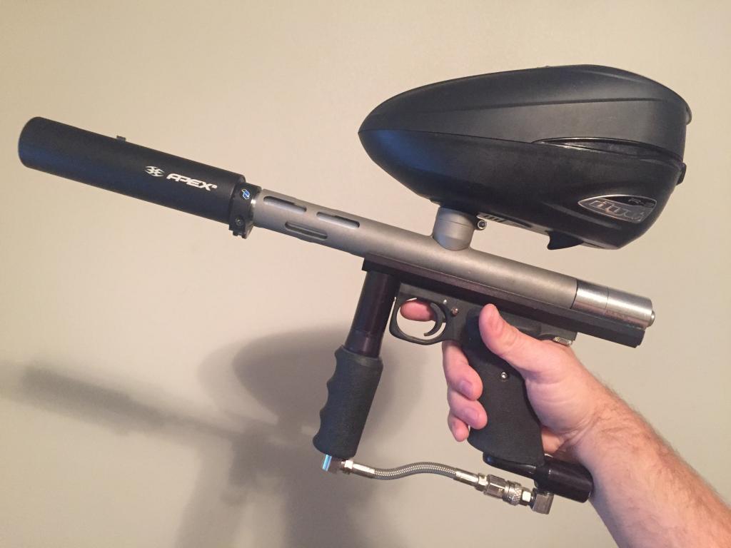

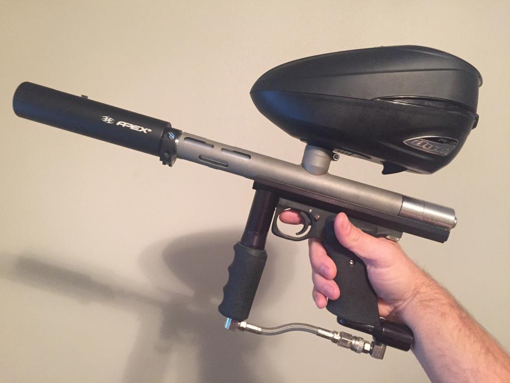

      Cocker because Apex2.

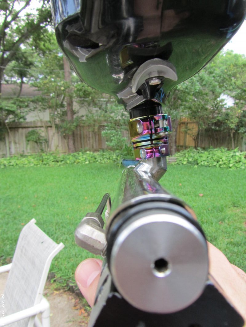

        • 8371
        Awesome.
        I also dont care for using an elbow to attach the hopper....

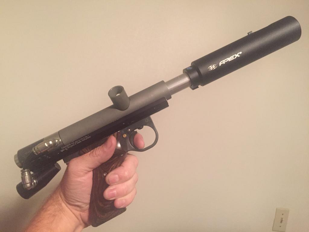

          Also a legitimate concern. Ask and ye shall receive

            Now that I agree with. I hate all of the rerouting of paint to get it from point A to point B.
            For the most part I really don't care which version is used unless paint is broken in it. Then TL all the way for cleaning reasons.
            TL in its final form still had one key issue to me. The detent system is horrible with FF hoppers. And FF was in wide use at the end of the TL era. Glued in Geo detent fingers can work basically like a docs adaptor. TL in today's use has an added issue of barrel size due to the ever shrinking balls.

                  Anyone else drooling?

                    Haha, thanks. Going_home inspired the idea to put the Apex 2 with the Deadly Winds adapter on a minimag barrel just yesterday. I never even thought of doing it until he said that putting an Apex on a twist-lock wasn't an option. Fits perfectly and looks pretty damn good, too, if I don't say so myself. Who says these discussions aren't productive? Classic MOTM?

                        Question is does the Apex function as its supposed to on the twist lock....

                          That's a good question. Although I can't imagine why it wouldn't work, I haven't actually tested it yet. It works just fine on a Deadly Wind Fibur X barrel, but this might be the first time anyone has ever tried this on a twist-lock. Only one way to find out for sure. Get back to you with the results after this weekend. I got an outlaw woodsball game this Sunday.
                            • 8371
                            When I bought an Inception Freak back the front needed to be .697 for use with an Apex tip.
                            So bore size is part of the equation for the Apex to function correctly.
