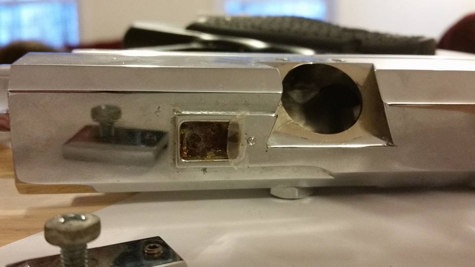

      Thanks Walker. Definitely missing the plate on top of the bumper. My "bumper" is more of a semi solid cracking ooze.
        Oh ok. Yeah you need the rubber piece. You can go with a spring but the pressure from the rubber piece should help with the score backing out.

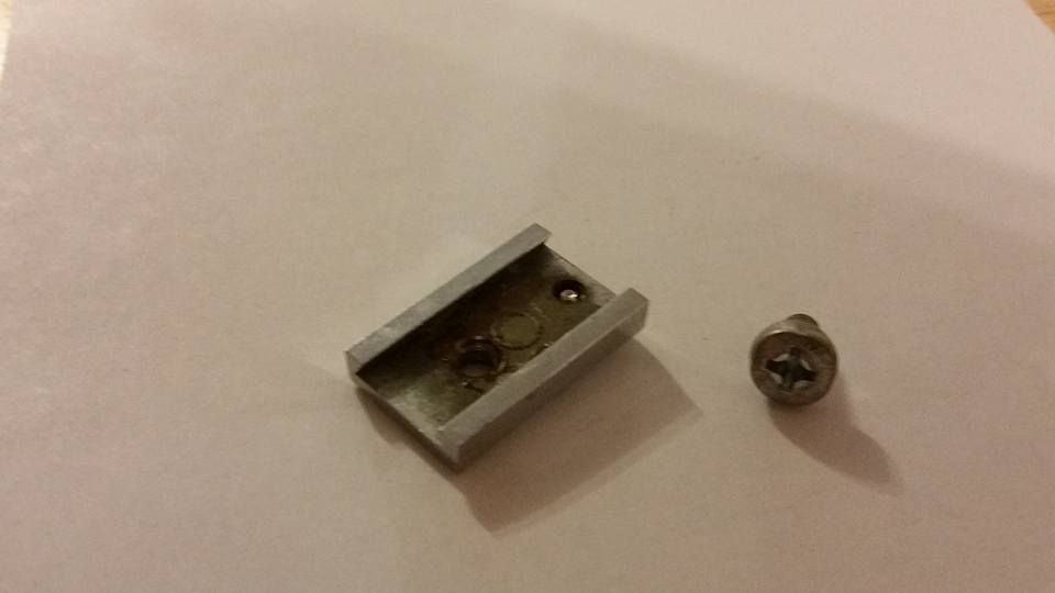

                  i see you have everything you need. but the backspin rubber is on its last leg.
                  im going to remove it and get to making a proto of it,
                  ill go from there if thats cool.
                  i see you have a buddy of mines adapter for the feedneck.
                  its nice. the quality they make it from is better than i thought.
                  props to the company that does this for people
                  ill have my machines pumping parts out whenever people need them as needed.

                      i got the exact part printed. im going to mess with getting the settings dialed in to print it in my flex materials, and see what the best way to print this part is.
                      things are looking good.
