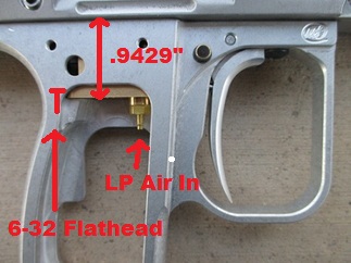

                            Would a mounting adapter cram in there? or is the geometry just ill suited..
                            Andy "Ydna" DuBuc
                            Nummech Products & ZDSPB
                              • 8235
                              #29
                              Honestly I was just guessing based on the pictures you posted. I'm not sure what all is going on with the built in airlines and such. Really it was just the short answer because I know you have one in the works.
                              My frames come with a built in mounting tab, but the frames I've modified all have a mounting bar like AGD's Intelli frame to attach a mounting tab to. Plus the T-Rex LP air is routed in through the bottom of the valve.
                              Here are the basics>
Name:	t rex mounts.jpg
                              I'll gladly share mounting specs for the T-Rex. The trigger pin is an off the shelf dowel pin so that's a non issue if a frame is non AGD spec in that area.
