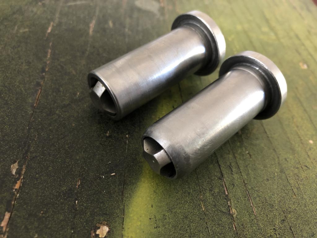

      I think there’s more to why mags don’t do particularly well with brittle paint, though. My hypothesis is that the top front of AGD bolts (L7 or L10) have a tendency to clip the bottom of the ball that is next in the stack when firing the ball in the chamber, especially if the ball diameter is small. This has the potential to weaken or crack the shell of the paintball in the stack. When that compromised ball falls into the breech, it is primed to explode the next time the trigger is pulled regardless of the how slowly the user is shooting.
      Though this hypothesis is not confirmed with roundball, I found that while testing First Strikes in the magfed Automags I build, an unmodded L7 bolt had the tendency to snag onto the skirt of the next FSR in the stack about 1 in every 20 shots, resulting in damage to the plastic skirt and/or capsule of the next FSR in the stack, and sometimes even flipping it before it entered the breech.
      My solution was to taper/round off the bolt tip to prevent it from snagging onto the following FSR’s skirt and instead help the bolt smoothly glide over it. Think of a bicycle tire riding up a crosswalk ramp vs. riding straight into a curb. Same idea.
      This modification worked extremely well; FSRs shoot flawlessly now. I can’t help but wonder whether this same approach would help hopper fed automags handle extremely brittle roundball better, too. If I ever get around to dropping what little coin I have on a box of uber brittle tournament paint just to test this, I’ll post my results here... if anyone is interested.

          i think ghost flanker is correct about it seems more that the first ball in the stack sticks into the breach too far and gets fractured by the bolt passing by. if you have problems you could try one of the older foamie level 7 bolts.

                            I would think grinding that much off would result in in lower velocity. How high can you crank it up now that you modified the bolt?
