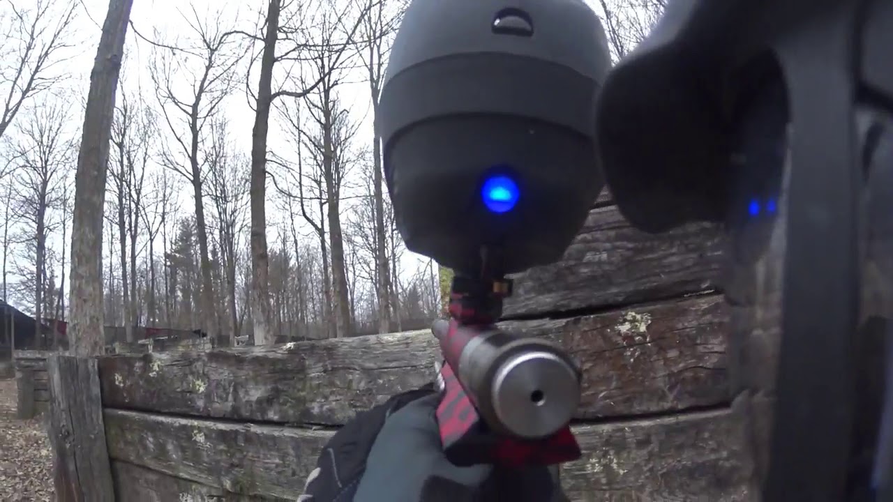

                            My game play today.....mag shot pretty well.
