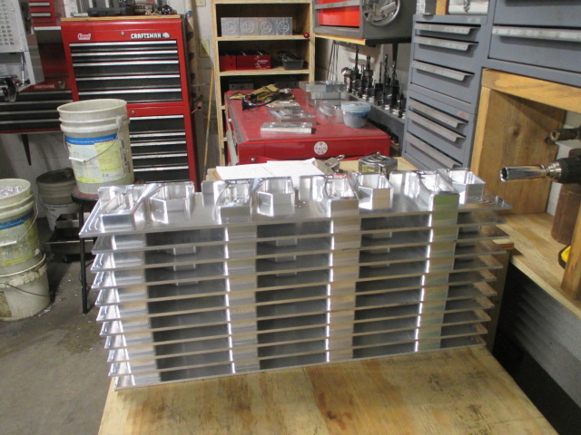

          Here we go guys, first of the double COOL HaND Luke frames...
Name:	Cool Hanf Luke Double Production Start.JPG

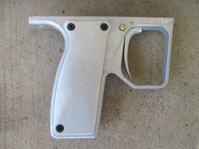

                CHL grip frames are done. Been working on grip panels for a few days, triggers to follow..
Name:	CHL complete.JPG

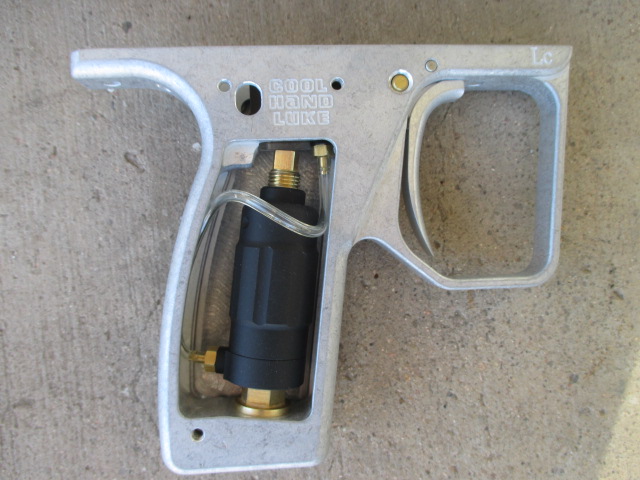

                    • 8216
                    #39

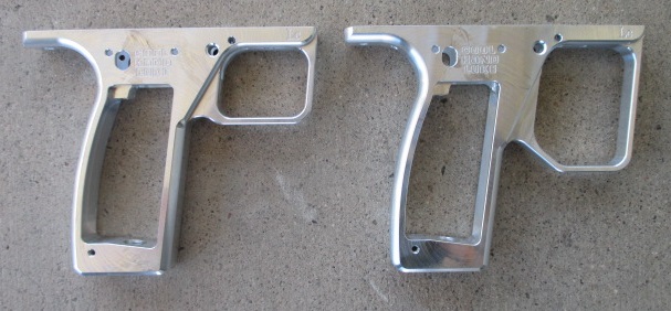

                    First few frames I could build hit the post office this morning, but there's more production to do.
Name:	Cool Hand Luke T Rex Build.JPG
Name:	CHL Double.JPG
                    • awo702
                      • Aug 2015
                      • 473
                      #40
                      Cool Hand Luke
                      They look great!
                        • 8216
                        #41
                        Thanks AWO!
                        just a note, these panels look flat but they are 3d machined like previous versions I've done.
                        • npaiva86
                          • Mar 2019
                          • 1
                          #42
                          Hey Luke, are you offering the frame with T-Rex and LPR already installed?
                            • 8216
                            #43
                            I dont have it listed that way but if you order the parts it will ship fully assembled. These will be available in black but I dont have ano costs yet..
                              • 8216
                              #44

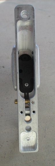

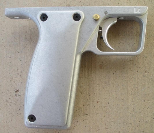

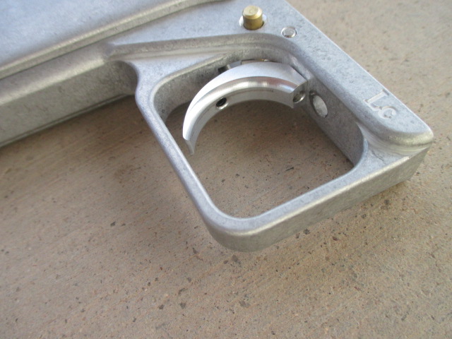

                              I haven't given many updates on the COOL HaND LUKE frames, but as promised I haven't taken any days off, I even worked the holidays. Anyway I'm close to wrapping up the project. The first, ready for production single trigger prototype came of the mill yesterday and I have one more program to run on the new Katana-2 double today. I've tightened up the specs, machining, and fixtures for the new triggers. All triggers will now be setup with the double magnet return system, a magnet in the trigger and grip frame. All frames, either pneumatic or mechanical will ship with magnets. I eliminated the top adjuster screw on the trigger and removed the typical extra forward travel from the design. These are designed with factory sear rod specs in mind.
Name:	CHL Single Trigger Prototype.JPG
Name:	CHL Single Mag Return.JPG
Name:	CHL Single T Rex.JPG
