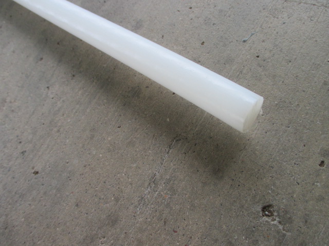

                        I wonder if you could turn some ptfe on a lathe to make the seals? It's hard but it does have a little give to it.
                        I have this stuff it's 5/8 diameter
                        • Xmagterror
                          Custom Automag parts
                          • May 2006
                          • 872
                          #27
                          [ATTACH=CONFIG]102789[/ATTACH]
                          Im not sure. That stuff is like cutting jello.
                          Maybe with special super sharp tools and a collet setup.
                          I've got some of that material here too
                            • 8248
                            #28
                            I've machined a lot of it will great success
