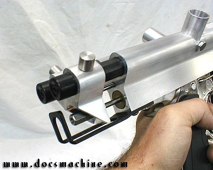

I think the best part about that entire setup.... the ram!
Can't tell from that pic, but the ram is actually going down the MIDDLE of the body. Not on the side by a groove, but through the body. It's a damn fine piece of craftsmanship.

It is indeed milled from a single block. It's a once-piece body:
"Freeflow parts are the best", eh?
Ah, I love the mindless parroting of advertising hype...
"Freeflow" rams are SMC units, just like most of the others out there, and SMCs aren't a whole lot different than Clippards, and Clippards aren't a whole lot different than stock WGP rams. If it's in good shape (isn't binding or worn) one ram will work just as fast as another- with, perhaps, very, very minor variances due to the internal volume, but this is on the scale of small fractions of a millisecond.
I'm using a Palmer's QuikRam, (which is a custom-designed piece made by Clippard) since it's a larger bodied unit, and one of the only ones out there that actually was designed for PB gun use.
Freeflow valves are not significantly different than stock valve, RATs or Orracle units. I'm using a custom-made "Tornado" copy I milled from steel, with two ports and a real Tornado cup seal. I do want some measure of efficiency from this thing, and the Tornado is one of the few "clean sheet of paper" designs out there that does what it's advertised to do- allow for greater efficiency and thus allowing a reduction in operating pressure.
