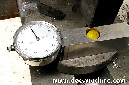

        First off, how much does the ball distort? To answer this, I whipped up a quickie little aluminum doodad. It has a flat-bottomed .750" hole and a cross-drilled hole for a dial indicator. I used a .0005"-graduated indicator, held in by a firm press-fit. The paintball goes in the big hole and the spring-loaded indicator shaft holds it against one side.

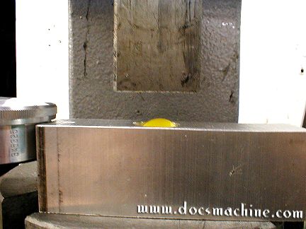

        I zeroed the indicator dial and put the works in my handy-dandy arbor press. The paintball, in this case, when resting against the bottom of the hole, stuck up by almost exactly 0.075".

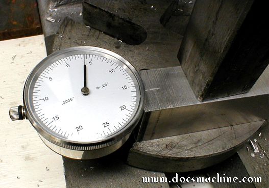

        All that remained was to squash the ball in the press that seventy-five thousandths.
        Total gain in "bore" diameter of the ball: just over 0.0035", or three and a half thousandths of an inch.
        Is this a "realistic" test? No: Firing the ball for real applies pressure over the entire half of the ball, the entire hemisphere facing the bolt. This test focused the pressure on two flat surfaces, exaggerating the distortion. In a paintball gun, the burst of air would spread out to conform to the entire half of the paintball, reducing the forces to a minimum.
        Also, I was forcing the ball into a hard surface. In the paintball gun, the only resistance facing the ball is the ball's own inertia and the very minor drag- if any- from the bore itself. In other words, it has only an open barrel to hold it back.
        So unless I'm missing some interesting factor, it looks to me like, if we give the ball the absolute worst possible conditions in an effort to induce distortion, we get only .003" to .004" change.
