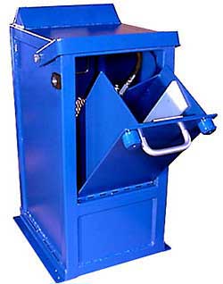

      If HPA breathing systems are filled by proffesional specifically trained firemen using fill stations that enclose the tank in a half inch of steel and limit the fill rate, why is it paintball markers are filled by ten year olds in seconds with no protection?
      Paintball is currently just an accident waiting to happen.
      Perhaps a small fill system that regulated fill speed would be a good idea. If it was small, those that do value their life and equipment could at least have one to fill their tanks.
