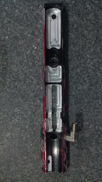

    Note: some of you may notice that by cutting the slot in the back of the rail for the x valve milled through one of the NPT air holes....lucky for us AGD did not connect the back left two air fitting holes with the input for the valve! thought i would mention that to avoid the posts by people.

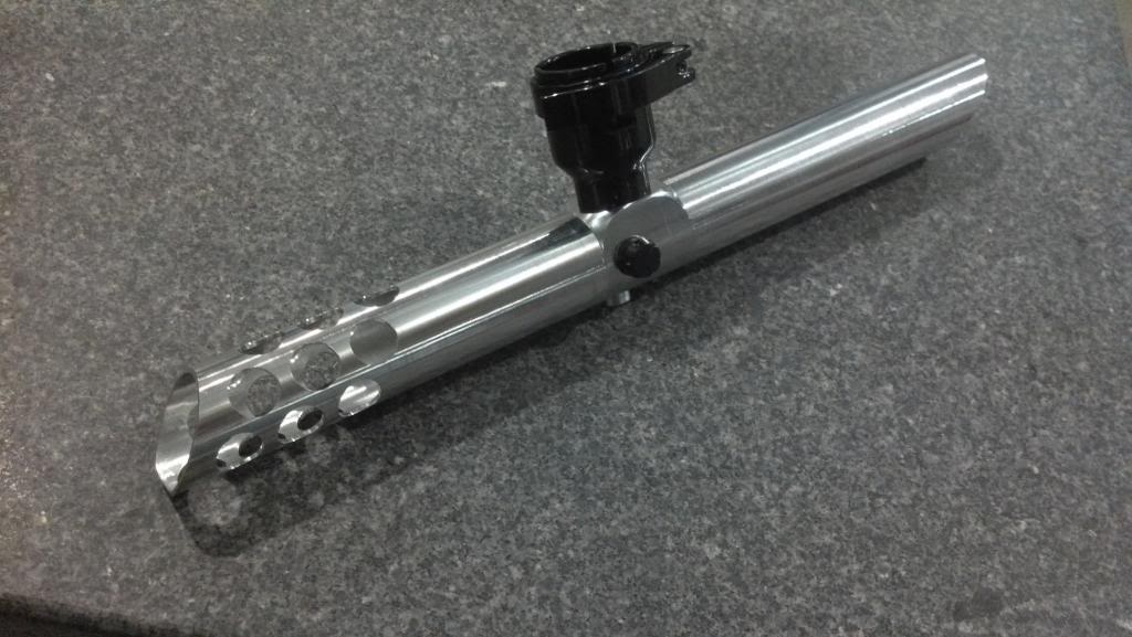

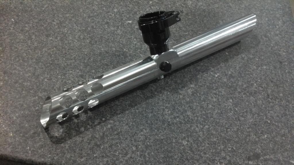

    Classic RT ULE body (uses stock RT valve)

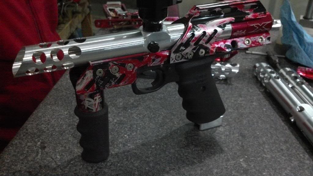

    The above body on my red smear automag RT

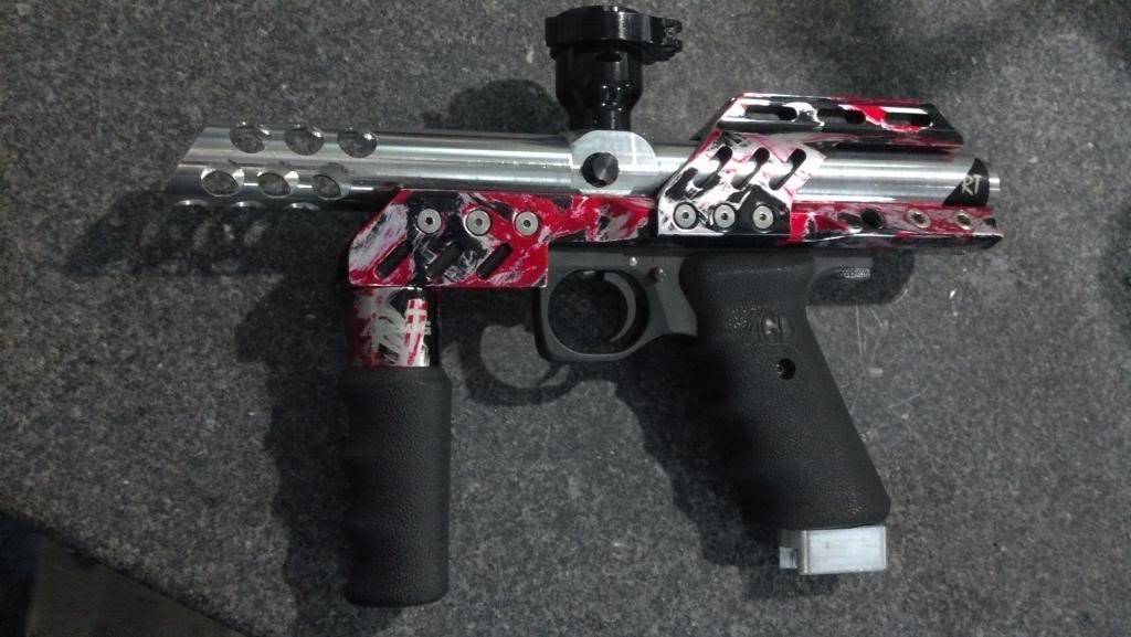

    Classic RT body for use with X valve...Shown on my red smear automag rt (This body will cut 11 oz. off your gun when used with an X valve and the ULE rail milling(shown below))

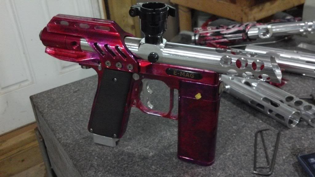

    This body will work with all other automags except for the classic automag RT and the sydarm...Shown on my Acid Red Emag

    ULE milling for classic RT rail....this milling is necessary to make the classic RT accept the X valve. reduces the weight of the rail by 30%
