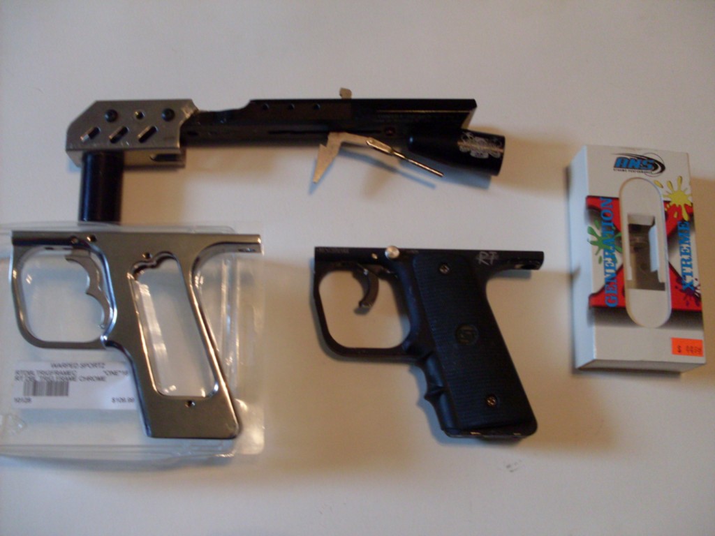

          You only need to take off a little bit of the rail to fit the body. Here is the quickest pick I could find:

              Thanks for the pic. That gives me a good idea of what I need to do.
