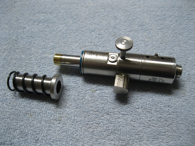

Just got this: what do I have?

    Hmm... a little sticky going on. The o-ring sorta sticks out the side, so I'm wondering if I've got too large an o-ring by accident.

      Which oring are you talking about?

        The one between the power tube tip and the valve assembly.

          When the brass powertube tip is screwed onto the stainless powertube, there should not be any oring showing. The brass tip should sit flush against the end of the powertube. That oring is only designed to provide tension to keep the powertube tip from vibrating loose.
            So I read this wrong, then? D'oh

              This is what your valve should look like when assembled.
              If you have that oring acting as a spacer, it will throw the whole spacer distance off for your setup. You will definately get bolt stick.

                #82
                Okay, got it!
                First off, miracle of miracles, my remote line plug is leaking, so I'm wondering what I did this time >_<
                That said, screwing straight in fixed that. Air out the back, but pulling back on the velocity worked. Some shots had dropoff, others were fine, no bolt stick, but sometimes balls wouldn't feed even though it looked like there were in there. I still hear a *slight* bit of barrel leak as well. *le sigh*
