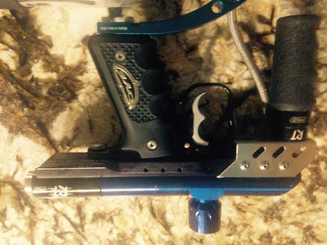

      That is what this site is here for. Honestly, pic of the gun, bolt and body would help in identifying any problems you have.

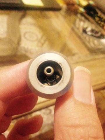

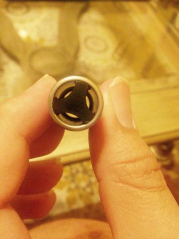

              Assuming your detent is good, though, I think the most likely culprit is the missing foamie on your Level 10 bolt. This is bad for 2 reasons:
              1.) The obvious... Foam is soft. Aluminum not so much.
              2.) Much more importantly, the Level 10 foamie is responsible for seating the paintball in the correct position up against the detent(s) and keeping it in-line with the ball stack. In the case of a missing foamie, the seated paintball is able to roll backwards about 1/8" towards the bolt. This allows the next paintball above to drop further down a little more and slightly in front of the seated paintball, creating more of a staggered stack rather than a true vertical stack. This sets the stage for a lot more friction between the first two paintballs to occur when firing. Now, when the gun is fired, the seated paintball must push the paintball on top and slightly in front of it out of the way. The paintball on top will either be pushed upward through the feedneck as the seated paintball underneath slides past it, or the two paintballs will simply be crushed into each other, which would explain the presence of paint in your feedneck. Or the paintball on top might only develop a hairline crack in its shell, thereby priming it to blow apart upon the impact of the next shot's air blast.

                    It doesn't have one, i.e. it was shot off the bolt face (there should be a place to put it on the bolt face, a cut out) or did it never have one? If you have a solid nosed bolt, then you did not have a L10 bolt.
                    I will order some and put one on the bolt. Now that you mention it... if you look closely at the face of the bolt (which is totally flat) you can see where it looks like something was glued there before.

                    I have attached an image of the gun and a couple of the bolt (1 of the back of the bolt and 1 of the front of the bolt). First time posting images... if you can't view them please let me know.
