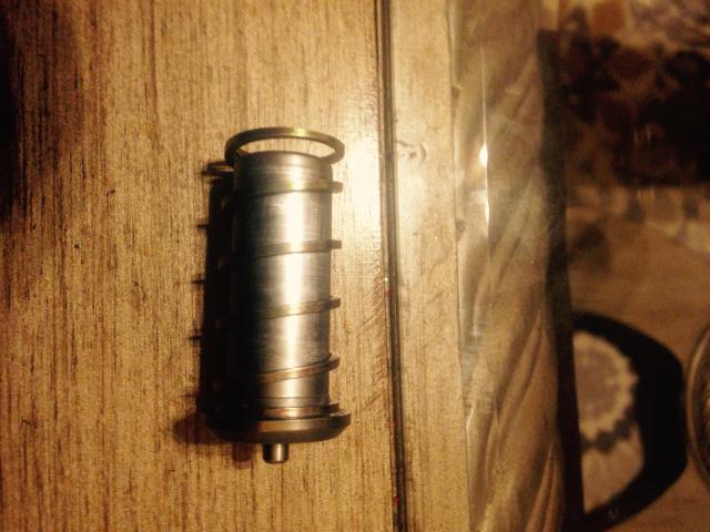

      It is the gold spring. It looks like a spring ;-)
      What do you mean exactly when you say "how does it look"?
      Thanks,
      mondoatx
        does it stick past the end of the bolt and how far? you may need a new one. and welcome to the forum by the way.

          Vintage,
          Thanks.
          Yes, the spring sticks out past the bolt.
          Here is an image:
Name:	bolt with spring.jpg
          • Beemer
            I could tell you but then.
            • Oct 2003
            • 3253
            Is that an illusion because of the angle of the picture or is that bolt stem off center?
              #21
              spring looks a little short to me. i'm sure a more knowledgeable person will chime in.
              • Mondoatx
                • Sep 2016
                • 206
                #22
                It is the angle... The stem of he bolt is centered.
