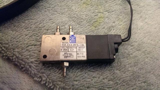

                Your spec sheet covers 6 solenoids, none of which are rated for 5 volts like the ones Renie and others use. You may actually have a 5 volt valve if you were just looking at the 43A model. You can see the 5VDC on the middle left of Renie's label. Check yours or post a pic of the label. You're not on the wrong track, it's just that something like that can cause some performance issues that will get you sooner or later.
                If you look at solenoid coils in general, they like high voltage for the initial pull-in, but they can only take a certain amount of steady current. That means if we are only powering them for about 10 milliseconds out of 50 milliseconds (which is called a 20% duty cycle), we can get away with almost doubling the rated voltage. When you give them lower voltage than they were designed for, they will be slower and weaker.

                    #24
                    when i bought it i figured good enough for a shocker/ viking god enough for what i want..... that is the only reason i got this so if i need a different noidl, barbs r just in random holes so i dont lose them lol.... lmk ty guys

                      #25
                      That noid will be fine you msy just have to test the port combination and use a m3 bolt/grub screw to block onefof the ports
                      try the setup I mentioned above

                        When you test it, don't leave 9 volts on it for more than a few seconds at a time. It's rated for 5 volts continuous and 9 should heat it up. Usually the electronics and short pulse limit the power, so if you direct connect it to a battery, use an old weakened 9 volt or a four pack of 1.5 volt batteries.
                        Idk how these act to over-voltage, but the little SMCs get a bit toasty.

                          Well the plan is to.use it with a 9volt all.the time? Should I.put a resatior in it or something?
                          • Spider-TW
                            U R techno-literate!
                            • 3555
                            #28
                            It's OK to use a 9 volt for a second at a time. Just don't leave the solenoid on for longer than that without letting it cool first. Normally, if you are shooting 20 bps, the solenoid will only be on for 10 msec at a time.
                              What!? Lol do I need to run a switch?

                                If you test the solenoid, not connected to a board, don't leave it connected to the battery. A switch is nice, but not necessary for testing.
