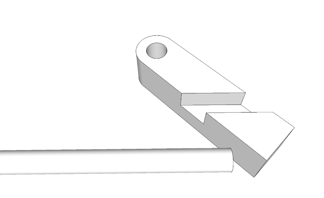

                            So thinking about the "block sear return" design, here's what I think needs to be resolved. Either:
                            1. Pump arm needs to reliably disengage from the sear block so it can't simply be held back and the marker is semi-auto again.
                            or
                            2. Sear travel is blocked by the mechanical "or" of the pump arm AND the blocking plate that's left behind.
                            I.e. In order to fire, the pump rod needs to go back forward AND the plate has to have been reset.
                            I think #2 is more feasible.
                            I was also playing around with this idea for the blocking plate:
                            Actually, I think I figured it out.
                              or

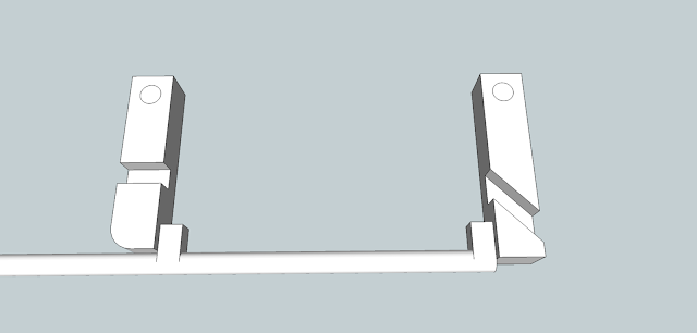

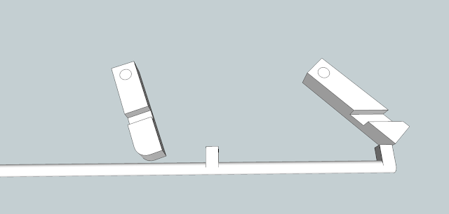

                                Sat down and drew up what I was thinking.
                                The two sliding plates are spring loaded; the back one wants to rotate forward, the front one wants to rotate backwards.
                                State 1: Back of sear has dropped into the back plate's channel, front plate is held forward by pump rod and the front of sear is free to drop into channel.
                                State 2: Gun is fired, back of sear raises up out of back plate's channel. When it does, the spring loaded plate moves forward and prevents the sear from dropping down again.
                                State 3a: Pump rod is actuated backwards, which pushes the back plate back.
                                State 3b: As soon as the back plate is back far enough, the sear drops into the channel, locking the back plate. Front plate disengages from the sear and rotates backwards, preventing the sear from being able to drop (i.e. safety).
                                Pump arm moving forward returns to State 1, where the sear is free to drop into the front channel again.
                                There are various details like the non-orthogonal shape of the sear, but I believe they can all be worked out.
                                The benefit is: you still get to use all your fruity artistic custom bodies without modding, and your level 10 without modding.
                                However, the drawback is it's a pretty rail intensive mod. All the magic happens inside the rail, and if you want to get down to the nitty gritty, I think the pump rod and the rotation pins for the plates are outside of the 1" width of the rail if you want a full 0.68" pump stroke. So this might not even be able to be retrofitted on any existing rails.
                                Of course, if you have a 3d printed rail, the rail mod is cake.
