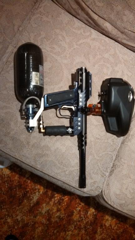

              Curious what I would need to take this back to stock. I know I'm not far from it. What else would I need besides an RT sight rail? What type of ASA did these come stock with? And I'm torn, I like the chunky AGD grips it has but really don't like composite frames. Is there an aluminum version that would take these grips or would switching to a different single trigger frame be a good idea?
                it would need the dust black aluminum sight rail, and the rt foregrip. they did not come with asas; it had a beefy cast 90-degree elbow and a male quick-disconnect fitting in the foregrip. it's not very practical though, so i just use the agd bottom bottle adapter. to connect it to the foregrip you can use two elbows and a 7" stainless hose, or two elbows, a quick-disconnect and a 5.5" stainless hose.
                the composite frames are very strong, and are the lightest frames agd has. agd lifted a small car with one of those frames to demonstrate their strength lol.

                  So the RT Classic game with the RT grip not a bike grip?
                    Here is my personal RT. The Y was not stock. Or the barrel. But the hardliners/for grip/sight rail/Ect is OEM from its original purchase.
                    Pretty sure the only thing I've ever done to this marker is change grip frames, barrels, and air system. It even still has a level 7 bolt and its original rt on off.

                      Ok cool. I like the look of the RT foregrip better anyway.

                          Good to know thanks guys. On the hunt for a RT foregrip and sightrail now along with an AGD ASA

                            Finally had a chance to take it out. Holy cow this thing is fun! Need to get a new elbow though, one seller provided is cracking.
