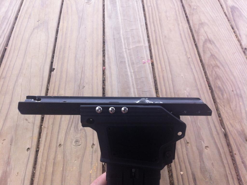

                  • bowcycle
                    • Apr 2012
                    • 733
                    #24
                    Originally posted by renie
                    cross that bridge once I come to it need to draw up the magwell 1st then see what positioning is like
                    on my bottom fed using DAM mags, I turned the magwell backwards to get the mags as far to the back as possible. This made frame fabrication a necessity. However, if you're willing to have the front of the mag line up with the front of the rail, it might work without all the extra work.

                          the tipx zeta mag would make for a more sten looking set up for a side feed but they are $25.00 a piece whereas the DAM mags are that price for 2.
                            #28
                            you can have a magazine that is in a more forward position, so that you don't have to modify the frame.
                            the part that needs to be remade is the BOLT it needs to be longer.
                            for this you just move the feed port and threading for the barrel and detents forward effectively making the body longer.

                              #29
                              Making a new bolt is kind of where things die though. No magazine system is going to make me give up my LX bolt.
                              The price difference between DAM and Zeta mags doesn't seem to be a significant differentiator. I've seen you guys dump more money on more frivolous stuff.
                              Main differences:
                              1. Geometry; profiles are slightly different, and some are better for certain situations, it just varies.
                              2. DAM mags are more "protected".
                              3. Zeta mags solve the "3rd hand reload" problem. You can reload a live mag, on gun, while still having a gun that is up and ready. Trickier to do with a DAM since the second half is covered up in the mag well.
                              Speaking from personal experience, a sten-style gun isn't really that fun. It is the simplest and most compatible configuration though.
                              I think you would get the most mileage out of a sane side-feed mag body. Leave the specific magwell off as a separate piece, that way you can switch between DAM or TIPX or even a rotary FSR loader. You can also warp/q-loader it or put a spring feed on it. Remember: less is more. You make a fancy machined 1-piece body with the mag well built in, then that is *all* that body will ever be good for (and perhaps not even that).
                              Easiest route would essentially be a stainless body, cut a through-hole feed port straight through it so you get both left and right feed orientations in the same body, and two weld nuts on top for accessories.
