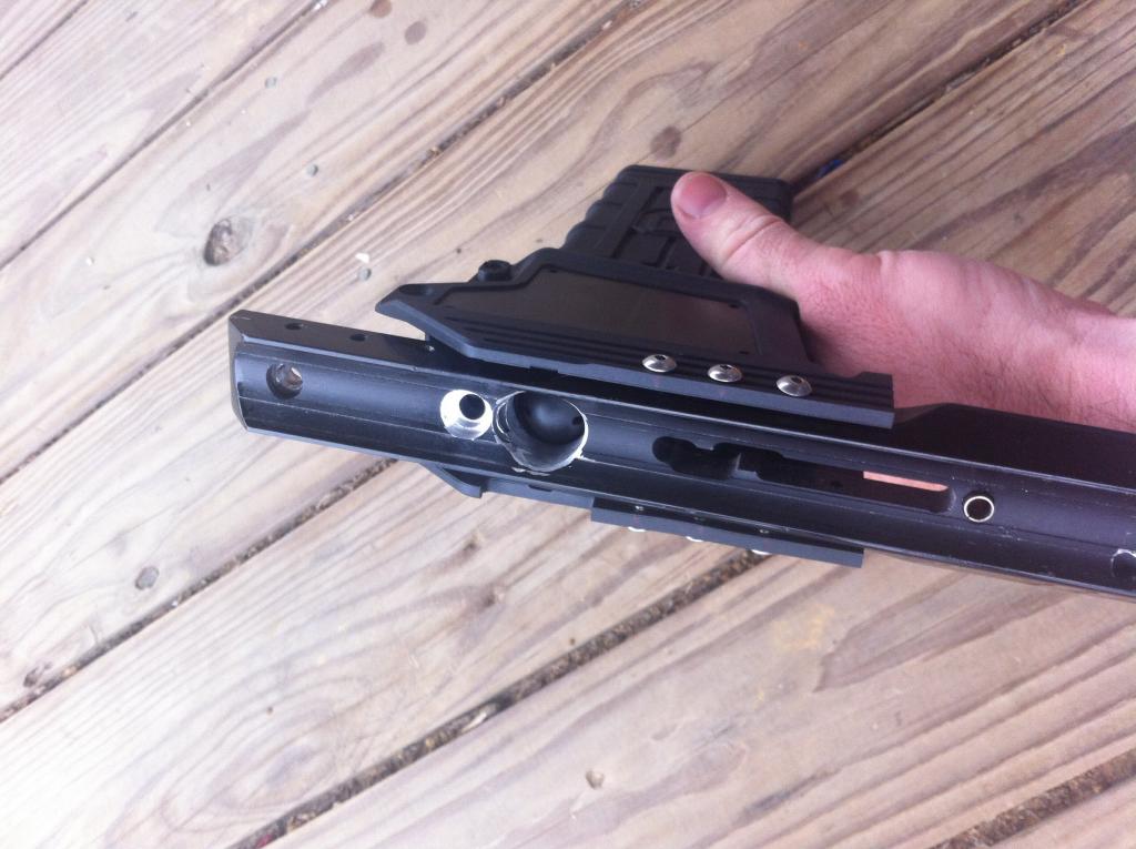

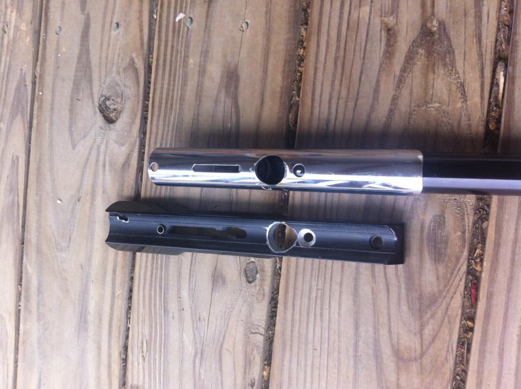

      Just so you see how I did it:
      I tried to go with the simplest method possible using the least technical equipment possible. I do have a machinist friend who is able to help me out, but I wanted to use him as little as possible.
      I used a center-feed body with twistlock so I could drill straight down through the body and rail using my drill press. This made sure that everything would be aligned for feeding purposes.
      this process destroyed the PIM, so I welded a new one in place over the twist-lock hole and drilled the rail out accordingly.
      I now use a Doc's adapter for the breech and use one screw to hold the body and rail together and keep the Doc's adapter in place facing down. The length of that screw is critical.
      • bowcycle
        • Apr 2012
        • 733
        #33
        The last problem to overcome was getting the balls to feed properly. The mag is pushing past 1/2" of rail that it's not intended for. Also, the force of the mag pushing into an empty chamber would crack the first ball every time. I finally learned to preload at least 1 ball into the chamber to keep from having a gooey mess down the barrel on the first shot.
        After that, the ball stack has to be pretty precise.
        Others may have more creative solutions, but mine was simply to glue a thick rubber pad on top of the pushers in each mag. The mags now only hold 9 balls each, but it works.
        Best of luck with your designing.
