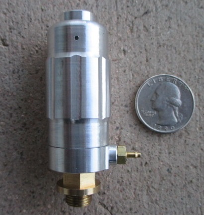

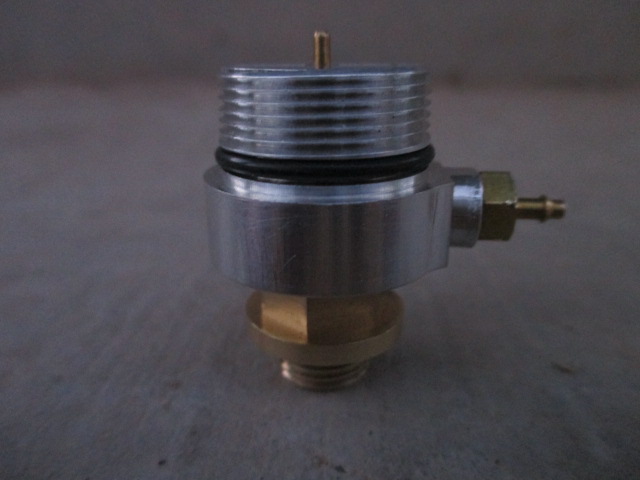

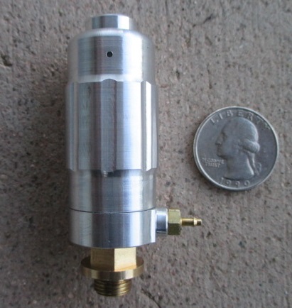

            Here's a few pictures of the LPR prototype, first picture shows the modified 1/8 pipe thread compared to a standard fitting. The P90 LPR works in all 1/8 NPT threaded holes and uses an o-ring seal. If there isn't a flat surface for the oring to seal on you can use thread sealer for those applications.

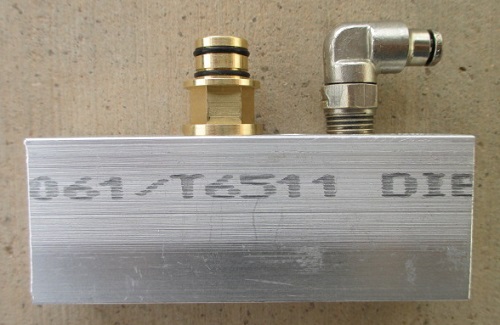

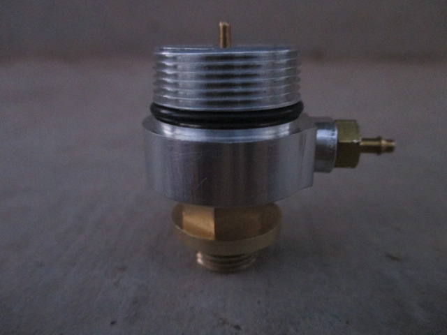

            Partial assembly, brass fitting with the swivel manifold. Working on the housing next.
Name:	MP90 LPR Manifold.JPG

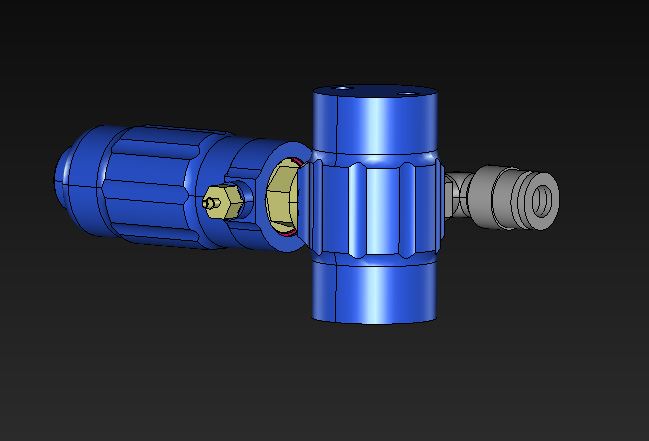

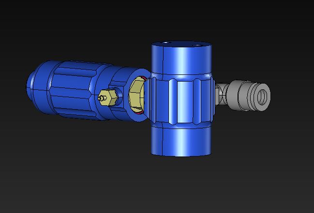

            Full assembly drawing
Name:	VASA Final Longer.JPG

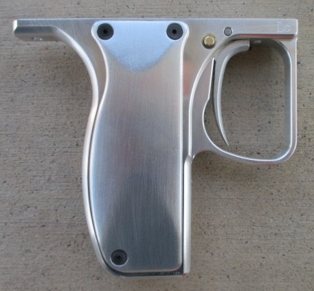

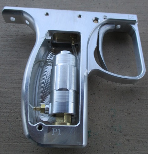

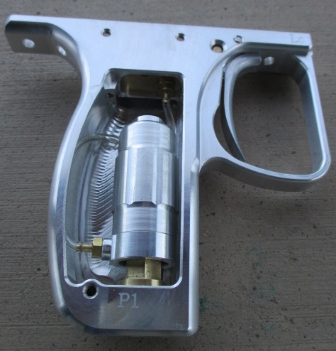

              Making some progress, design and machining is dialed in. I still need to machine the MP90 to mount the reg and do the testing, but I should get the machining done tomorrow and get started on testing. When that's done it will go direct to production. This brings both the MP90 and Z2 closer to production, lots of parts to make but we're moving forward.
Name:	P90 LPR complete.JPG

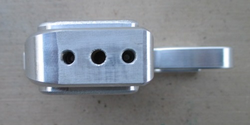

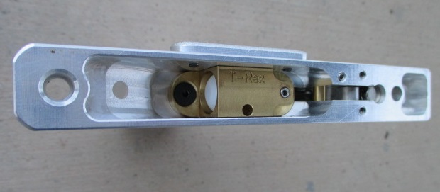

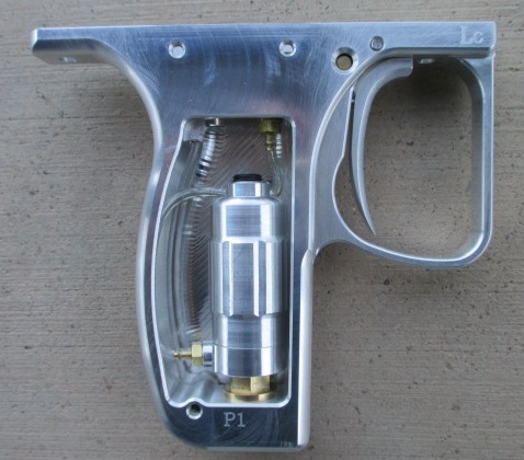

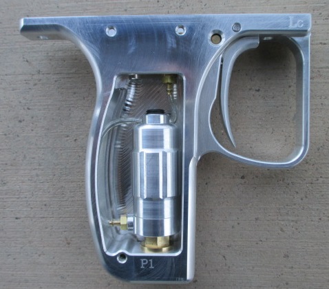

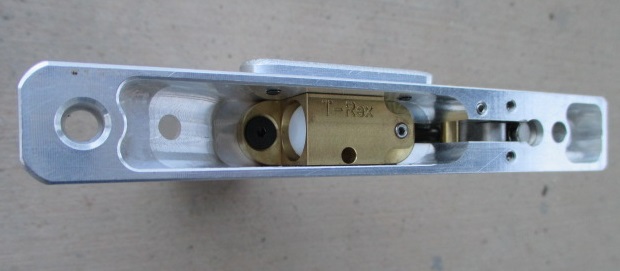

                  Time for testing.
Name:	P90 Reg Mounted in MP90 001.JPG
Name:	P90 Reg Mounted in MP90 005.JPG
Name:	P90 Reg Mounted in MP90 004.JPG

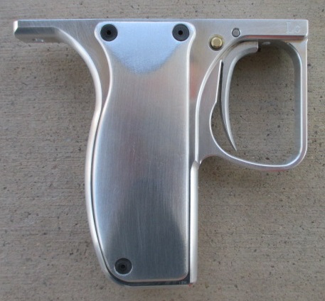

                  Gas through through frame is done a little differently than what's come before.
Name:	P90 Reg Mounted in MP90 008.JPG
